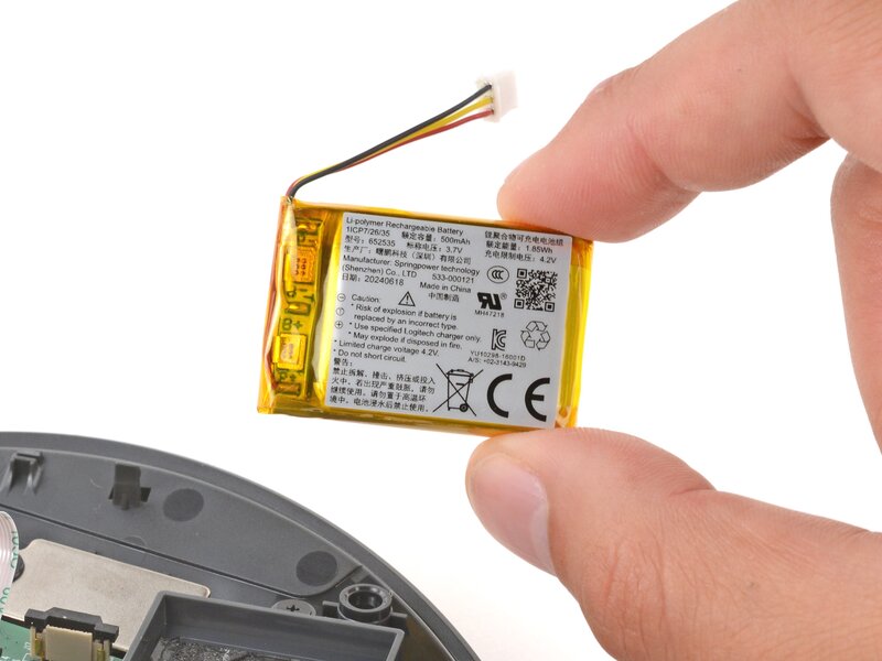

    1. Logitech MX Ergo Plus Battery Replacement, Disconnect the battery: step 13, image 1 of 2 Logitech MX Ergo Plus Battery Replacement, Disconnect the battery: step 13, image 2 of 2
      • Use the pointed end of a spudger to push up and the battery connector, loosening it in its socket.
      • You don't need to push the connector completely out of its socket yet—you'll do so in a few steps.
      Ask FixBot
    2. Logitech MX Ergo Plus Battery Replacement, Pry out the battery: step 14, image 1 of 3 Logitech MX Ergo Plus Battery Replacement, Pry out the battery: step 14, image 2 of 3 Logitech MX Ergo Plus Battery Replacement, Pry out the battery: step 14, image 3 of 3
      • Insert the long edge of an opening pick between the long edge of the battery and its housing, at the side opposite the battery cable.
      • Use your opening pick to pry up the battery and separate its adhesive. Apply steady, constant force and slide the pick farther under the battery as necessary.
      • Make sure you push the pick underneath the battery and not into it. Don't bend or deform the battery.
      Ask FixBot
    3. Logitech MX Ergo Plus Battery Replacement: step 15, image 1 of 2 Logitech MX Ergo Plus Battery Replacement: step 15, image 2 of 2
      • Use your fingers to lift the battery out of its housing.
      Ask FixBot
    4. Logitech MX Ergo Plus Battery Replacement, Remove the battery: step 16, image 1 of 3 Logitech MX Ergo Plus Battery Replacement, Remove the battery: step 16, image 2 of 3 Logitech MX Ergo Plus Battery Replacement, Remove the battery: step 16, image 3 of 3
      Tool used on this step:
      Tesa 61395 Tape
      $2.95
      Buy
      • Use your fingers to grip the battery cables as close to the connector as possible and pull the connector straight up and out of its socket.
      • Remove the battery.
      • During reassembly:
      • Never install a deformed or damaged battery, as doing so is a potential safety hazard. Replace it with a new battery.
      • If the battery adhesive is still sticky, you can reuse it. Otherwise, remove all the old battery adhesive.
      • If your new battery has adhesive pre-installed, remove the plastic liner to expose the adhesive. Otherwise, apply strips of thin, double-sided tape to the battery well (not directly to the battery) where the old adhesive was.
      • Firmly press the battery into place, making sure the cables are on the side closest to their socket.
      Ask FixBot
