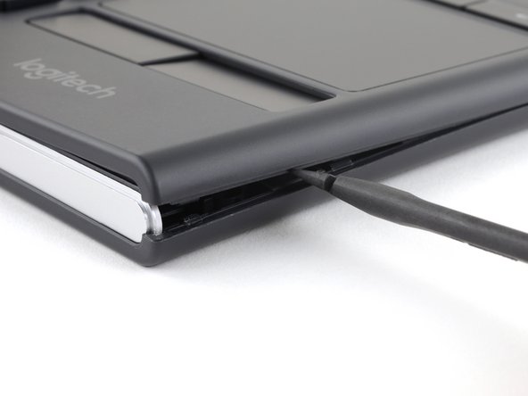

    4. Logitech K830 Battery Replacement, Release the clips: step 4, image 1 of 2 Logitech K830 Battery Replacement, Release the clips: step 4, image 2 of 2
      • The upper case is secured to the lower case by clips on every side of the keyboard. In the next steps, you'll release the clips on each side.
      • Insert an opening pick about 2 mm into the gap between the upper case and lower case at the bottom-right corner of the keyboard.
      • This creates a gap large enough to insert the flat end of a spudger.

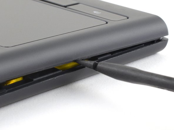

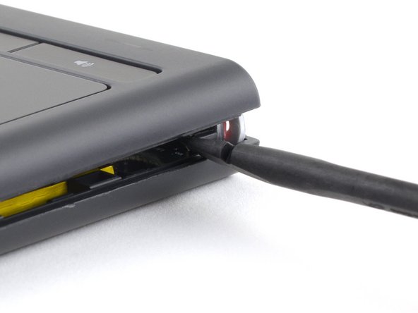

    5. Logitech K830 Battery Replacement: step 5, image 1 of 3 Logitech K830 Battery Replacement: step 5, image 2 of 3 Logitech K830 Battery Replacement: step 5, image 3 of 3
      • Don't insert the spudger more than 2 mm into the keyboard or you may damage internal components.
      • The internal battery is located near the right edge of the keyboard. Take care not to puncture or bend the battery with your spudger—a punctured or bent battery may leak dangerous chemicals or cause a thermal event.
      • Insert the flat end of a spudger about 2 mm into the gap between the upper case and lower case in the bottom right corner of the keyboard.
      • Rotate the spudger clockwise to release the first clip.

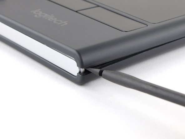

    6. Logitech K830 Battery Replacement: step 6, image 1 of 3 Logitech K830 Battery Replacement: step 6, image 2 of 3 Logitech K830 Battery Replacement: step 6, image 3 of 3
      • Move the spudger about 3 cm along the keyboard's edge toward the volume buttons.
      • Rotate the spudger clockwise to release the next clip.
      Ask FixBot

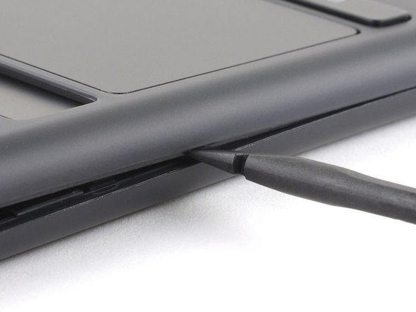

    7. Logitech K830 Battery Replacement: step 7, image 1 of 2 Logitech K830 Battery Replacement: step 7, image 2 of 2
      • The spudger should now be about in the middle of the right edge of the keyboard.
      Ask FixBot

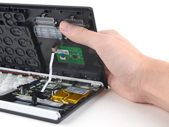

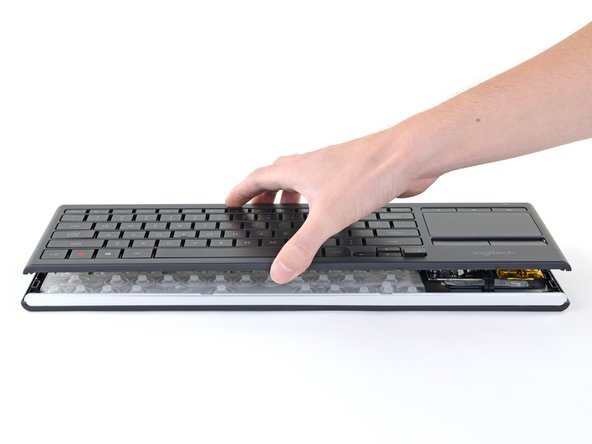

    14. Logitech K830 Battery Replacement, Open the upper case: step 14, image 1 of 3 Logitech K830 Battery Replacement, Open the upper case: step 14, image 2 of 3 Logitech K830 Battery Replacement, Open the upper case: step 14, image 3 of 3
      • Don't try to remove the upper case completely—it's still attached to the lower case by a delicate interconnect cable.
      • Lift the upper case up by about 2 cm.
      • If the upper case doesn't lift completely off of the lower case, repeat the clip release procedure for the stuck area.
      • Tilt the upper case about 45 degrees so that the keycap letters are upside-down.
      • Keep the upper case as close to the lower case as possible to avoid straining the interconnect cable.
      Ask FixBot

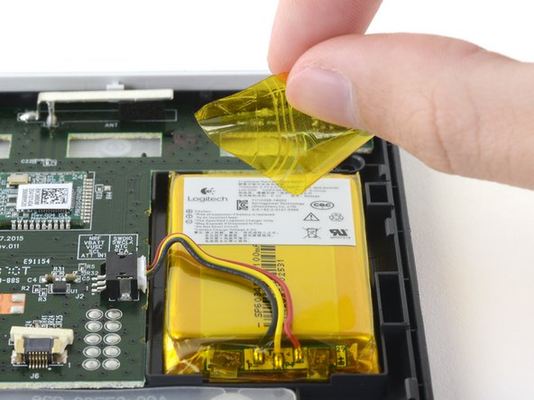

    21. Logitech K830 Battery Replacement, Disconnect the battery: step 21, image 1 of 2 Logitech K830 Battery Replacement, Disconnect the battery: step 21, image 2 of 2
      • Remove the yellow tape covering the battery cables.
      • Set this tape aside. During reassembly, place the tape back into its original position covering the cables on the battery.
      Ask FixBot

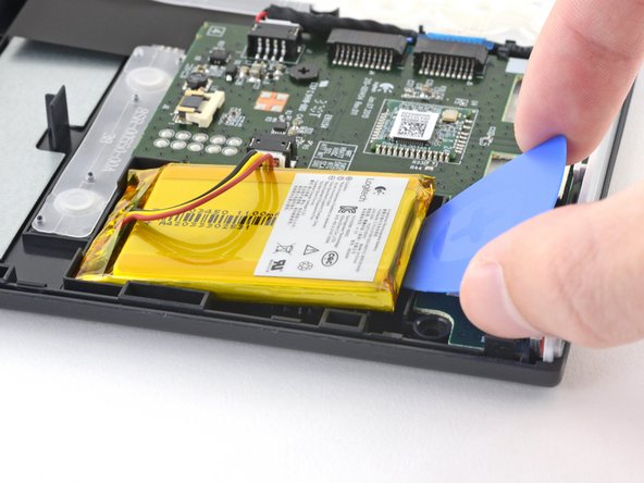

    23. Logitech K830 Battery Replacement: step 23, image 1 of 3 Logitech K830 Battery Replacement: step 23, image 2 of 3 Logitech K830 Battery Replacement: step 23, image 3 of 3
      • Slowly insert the tip of an opening pick under the top edge of the battery.
      • Make sure the opening pick is sliding under the battery and not pushing into the battery's side.
      • If the opening pick isn't sliding under the battery, apply more isopropyl alcohol and try again.
      • Push about half of the opening pick under the battery while slowly lifting up.
      Ask FixBot

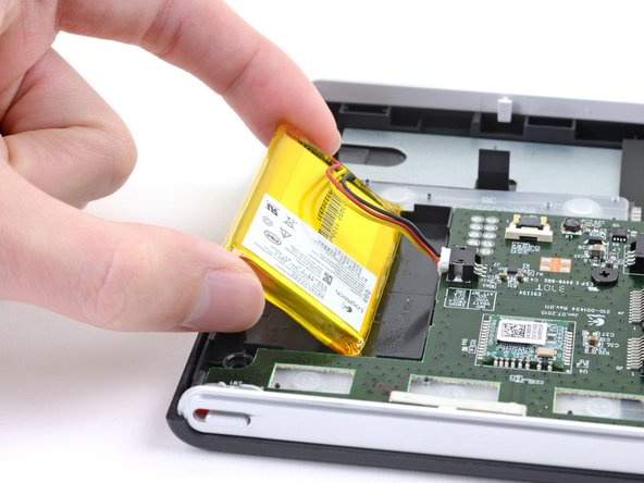

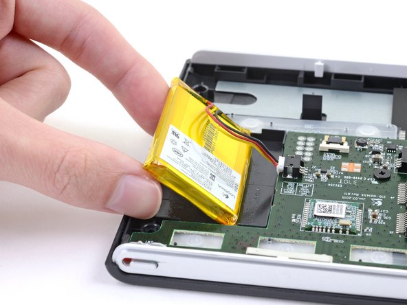

    24. Logitech K830 Battery Replacement: step 24, image 1 of 2 Logitech K830 Battery Replacement: step 24, image 2 of 2
      • Use your fingers to lift the battery about 1 cm above the battery recess.
      • Take care not to strain the battery cables while handling the battery or you may damage the battery connector socket.
      Ask FixBot
    25. Logitech K830 Battery Replacement: step 25, image 1 of 3 Logitech K830 Battery Replacement: step 25, image 2 of 3 Logitech K830 Battery Replacement: step 25, image 3 of 3
      • Rotate the battery 45 degrees so that the edge closest to the battery connector rests in the battery recess about 1 cm from the connector.
      • Place two fingers under the bottom side of the battery to support it.
      Ask FixBot

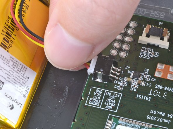

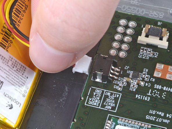

    26. Logitech K830 Battery Replacement: step 26, image 1 of 3 Logitech K830 Battery Replacement: step 26, image 2 of 3 Logitech K830 Battery Replacement: step 26, image 3 of 3
      • While supporting the battery, disconnect the battery by pulling on the three cables as close to the connector as possible.
      • If the battery connector doesn't easily come out of the socket, gently rock it back and forth to "walk" it out of the socket.
      • During reassembly, make sure the battery connector is oriented correctly. The black cable should be on the side closest to the ten solder points on the motherboard.
      Ask FixBot
