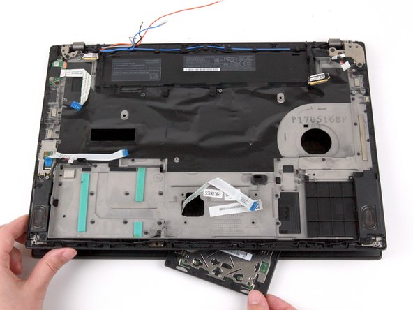

  48. Lenovo ThinkPad T470 TrackPad Replacement, Trackpad: step 48, image 1 of 2 Lenovo ThinkPad T470 TrackPad Replacement, Trackpad: step 48, image 2 of 2
    • Use a Phillips #1 screwdriver to remove the four 4 mm screws.
  49. Lenovo ThinkPad T470 TrackPad Replacement: step 49, image 1 of 2 Lenovo ThinkPad T470 TrackPad Replacement: step 49, image 2 of 2
    • Peel up the white ribbon cable.
    • Potential for device damage: The cable may be attached to the laptop with strong adhesive, so be cautious not to tear it.
  50. Lenovo ThinkPad T470 TrackPad Replacement: step 50, image 1 of 2 Lenovo ThinkPad T470 TrackPad Replacement: step 50, image 2 of 2
    • Use both hands to lift up the bottom frame of the laptop a few centimeters.
  51. Lenovo ThinkPad T470 TrackPad Replacement: step 51, image 1 of 3 Lenovo ThinkPad T470 TrackPad Replacement: step 51, image 2 of 3 Lenovo ThinkPad T470 TrackPad Replacement: step 51, image 3 of 3
    • Hold the frame up with one hand.
    • Use your other hand to slide the trackpad toward you and away from the laptop.

1. Turn off the internal battery via the Lenovo UFEI/BIOS settings.
2. Remove the external hot swappable battery.
3. Remove the bottom cover.
4. Remove the internal battery.
5. If installed, remove the second RAM card that is closest to the trackpad.
6. Unscrew the trackpad.
7. Remove and replace the trackpad.
See this video from January 2024 that shows this process:
https://youtu.be/q7elsgUMboc
