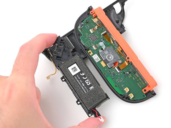

    10. Joy-Con 2 (Right) Joystick Replacement, Remove the back cover: step 10, image 1 of 3 Joy-Con 2 (Right) Joystick Replacement, Remove the back cover: step 10, image 2 of 3 Joy-Con 2 (Right) Joystick Replacement, Remove the back cover: step 10, image 3 of 3
      • Firmly grasp the two wires (yellow and white) above the rumble motor connector, located at the bottom of the controller's board, and pull the beige connector out of its socket.
      • Pulling the cable won't damage it, but don't dig your nails into the plastic sheathing.
      • Remove the back cover.
      Ask FixBot

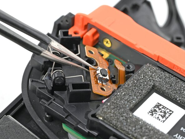

    2. Joy-Con 2 (Right) Joystick Replacement, Remove the release button: step 12, image 1 of 2 Joy-Con 2 (Right) Joystick Replacement, Remove the release button: step 12, image 2 of 2
      • Pick up the release button and remove it.
      Ask FixBot

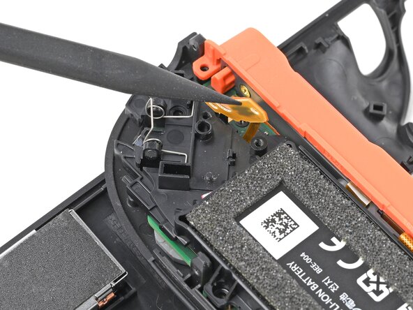

    3. Joy-Con 2 (Right) Joystick Replacement, Remove the trigger: step 13, image 1 of 2 Joy-Con 2 (Right) Joystick Replacement, Remove the trigger: step 13, image 2 of 2
      • If your JIS 00 driver is able to access the screw underneath the trigger button, you may skip this step.
      • Insert an opening pick between the bumper (R) and trigger (ZR) buttons at the top of the controller.
      • Use the opening pick to pry the trigger away from the bumper until it pops off the controller.
      • You can lightly hold the ZR button with your finger to avoid launching it.
