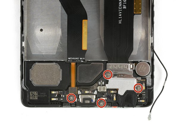

    1. Huawei P9 Plus Display with Frame Replacement, Display: step 11, image 1 of 3 Huawei P9 Plus Display with Frame Replacement, Display: step 11, image 2 of 3 Huawei P9 Plus Display with Frame Replacement, Display: step 11, image 3 of 3
      • Use a tweezer to remove the sticker that sits on top of the screw next to the antenna cable.
      • Unplug the antenna cable and release it from the bracket on the metal plate covering the main flex cable.
      • Remove the four Phillips #00 screws.
      Ask FixBot

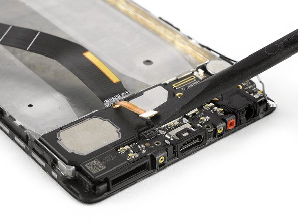

    2. Huawei P9 Plus Display with Frame Replacement: step 12, image 1 of 3 Huawei P9 Plus Display with Frame Replacement: step 12, image 2 of 3 Huawei P9 Plus Display with Frame Replacement: step 12, image 3 of 3
      • The plate, which is covering the motherboard flex cable, has little hooks on each side. Use a tweezer to free them and unhinge the plate by carefully moving it upwards.
      • Use a spudger to unplug the motherboard flex cable and remove it.
      • Unplug the flex connector of the loudspeaker.
      Ask FixBot

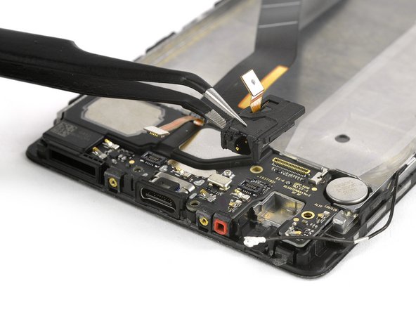

    3. Huawei P9 Plus Display with Frame Replacement: step 13, image 1 of 2 Huawei P9 Plus Display with Frame Replacement: step 13, image 2 of 2
      • Use a spudger to unplug the flex connector of the headphone jack.
      • Remove the headphone jack.
      • Be careful with the contacts inside and in the bottom area of the headphone jack. They can be damaged easily.
      Ask FixBot

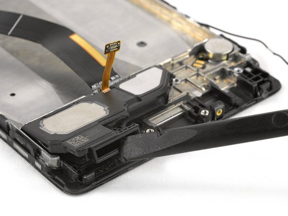

    4. Huawei P9 Plus Display with Frame Replacement: step 14, image 1 of 2 Huawei P9 Plus Display with Frame Replacement: step 14, image 2 of 2
      • Use a spudger to lift out the daughter board.
      • Lift the loudspeaker out of the mid frame. There is some adhesive underneath, so it can be a little bit sticky.
      Ask FixBot

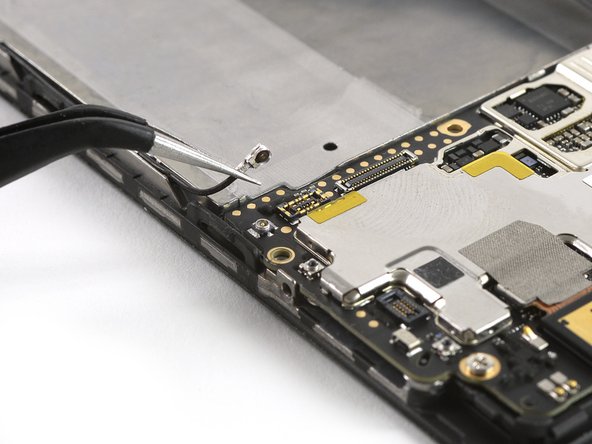

    1. Huawei P9 Plus Display with Frame Replacement, Display with Frame: step 15, image 1 of 3 Huawei P9 Plus Display with Frame Replacement, Display with Frame: step 15, image 2 of 3 Huawei P9 Plus Display with Frame Replacement, Display with Frame: step 15, image 3 of 3
      • Use a tweezer to loosen the vibration motor flex cable. Be careful since it is a little bit sticky.
      • Remove the vibration motor.
      • Use a tweezer to unplug the antenna cable and remove it.
      Ask FixBot

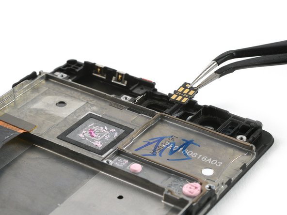

    3. Huawei P9 Plus Display with Frame Replacement: step 17, image 1 of 2 Huawei P9 Plus Display with Frame Replacement: step 17, image 2 of 2
      • Remove the earpiece speaker with a tweezer.
      • Take care of the metal connectors to not bend them.
      • Carefully remove the proximity sensor from its recess.
      Ask FixBot
