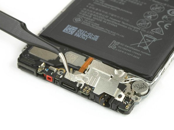

    1. Huawei P10 Plus Vibration Motor Replacement, Charging Board: step 8, image 1 of 2 Huawei P10 Plus Vibration Motor Replacement, Charging Board: step 8, image 2 of 2
      Tool used on this step:
      Buy
      • Remove the three Phillips #000 screw.
      • Remove the metal shield covering the charging board with tweezers.
      Ask FixBot
