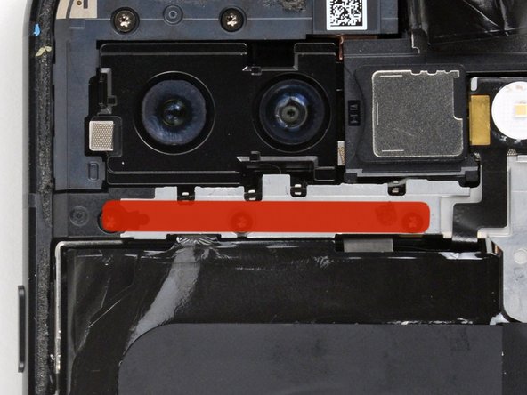

  2. How to Apply Back Cover Adhesive in Your Google Pixel 8a: step 2, image 1 of 3 How to Apply Back Cover Adhesive in Your Google Pixel 8a: step 2, image 2 of 3 How to Apply Back Cover Adhesive in Your Google Pixel 8a: step 2, image 3 of 3
    • Use a spudger and tweezers to scrape up and remove any adhesive from above and below the rear cameras.
    • If necessary, soften the adhesive with a hair dryer or heated iOpener.

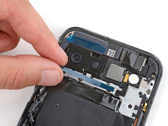

  5. How to Apply Back Cover Adhesive in Your Google Pixel 8a, Apply new adhesives: step 5, image 1 of 3 How to Apply Back Cover Adhesive in Your Google Pixel 8a, Apply new adhesives: step 5, image 2 of 3 How to Apply Back Cover Adhesive in Your Google Pixel 8a, Apply new adhesives: step 5, image 3 of 3
    • If you have a new back cover, your part may come with lower and top back cover adhesive pre-installed. If this is the case, you can skip down two steps to apply the perimeter adhesive.
    • Remove the shorter, wider strip of back cover adhesive from its liner and place it on the plastic housing just above the rear cameras.
  6. How to Apply Back Cover Adhesive in Your Google Pixel 8a: step 6, image 1 of 3 How to Apply Back Cover Adhesive in Your Google Pixel 8a: step 6, image 2 of 3 How to Apply Back Cover Adhesive in Your Google Pixel 8a: step 6, image 3 of 3
    • Remove the longer, thinner piece of back cover adhesive from its liner and place it on the logic board cover just below the rear cameras.

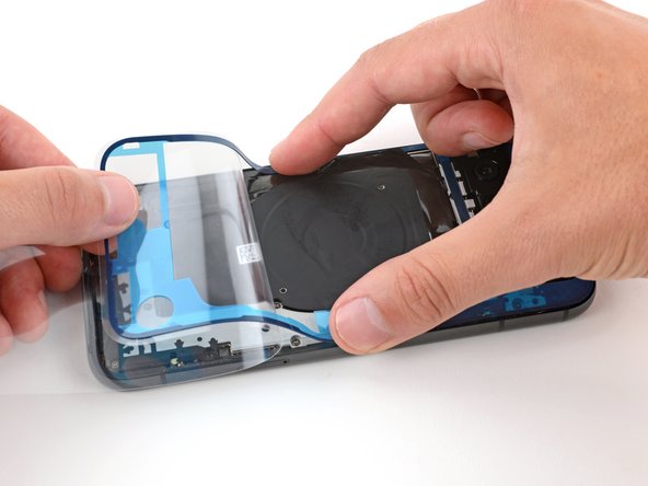

  10. How to Apply Back Cover Adhesive in Your Google Pixel 8a: step 10, image 1 of 3 How to Apply Back Cover Adhesive in Your Google Pixel 8a: step 10, image 2 of 3 How to Apply Back Cover Adhesive in Your Google Pixel 8a: step 10, image 3 of 3
    • Slowly lay the rest of the adhesive onto the frame, peeling away the large liner as you go.

  12. How to Apply Back Cover Adhesive in Your Google Pixel 8a, Remove the liners: step 12, image 1 of 3 How to Apply Back Cover Adhesive in Your Google Pixel 8a, Remove the liners: step 12, image 2 of 3 How to Apply Back Cover Adhesive in Your Google Pixel 8a, Remove the liners: step 12, image 3 of 3
    • Slowly peel and remove the blue liner.
    • If the adhesive starts to peel up with the liner, check that you’ve pushed all of it into place with your spudger. If it continues to peel up, hold it down with the point of your spudger as you go.
  13. How to Apply Back Cover Adhesive in Your Google Pixel 8a: step 13, image 1 of 3 How to Apply Back Cover Adhesive in Your Google Pixel 8a: step 13, image 2 of 3 How to Apply Back Cover Adhesive in Your Google Pixel 8a: step 13, image 3 of 3
    • Peel and remove the liners from the two smaller strips of adhesive near the rear cameras.

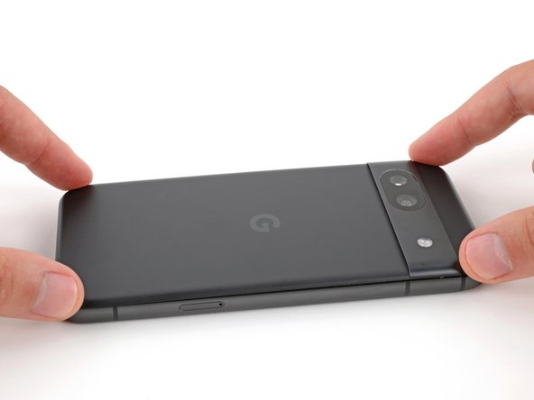

  15. How to Apply Back Cover Adhesive in Your Google Pixel 8a, Secure the back cover: step 15, image 1 of 3 How to Apply Back Cover Adhesive in Your Google Pixel 8a, Secure the back cover: step 15, image 2 of 3 How to Apply Back Cover Adhesive in Your Google Pixel 8a, Secure the back cover: step 15, image 3 of 3
    • Align the back cover over the frame and press it into place.
    • Firmly press around the perimeter of the back cover to secure it.
    • To further strengthen the adhesive bond, lightly heat the back cover's perimeter with a hair dryer or heated iOpener and continue pressing it into place.

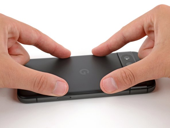

  16. How to Apply Back Cover Adhesive in Your Google Pixel 8a: step 16, image 1 of 2 How to Apply Back Cover Adhesive in Your Google Pixel 8a: step 16, image 2 of 2
    • Firmly press down on the back cover above and below the camera bump to secure the cover with the two smaller strips of adhesive.
