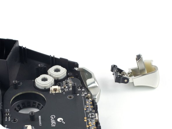

  17. GuliKit KingKong 2 Pro Daughterboard Replacement, Unfasten the trigger screws: step 17, image 1 of 1
    • Use a Phillips #00 screwdriver to remove the four 7.8 mm-long screws securing the triggers.

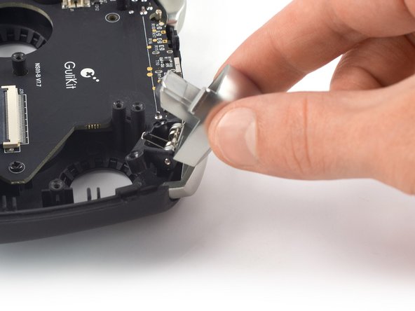

  18. GuliKit KingKong 2 Pro Daughterboard Replacement, Remove the left trigger: step 18, image 1 of 3 GuliKit KingKong 2 Pro Daughterboard Replacement, Remove the left trigger: step 18, image 2 of 3 GuliKit KingKong 2 Pro Daughterboard Replacement, Remove the left trigger: step 18, image 3 of 3
    • Use your fingers to lift the left trigger off its bracket.
    • Remove the left trigger.

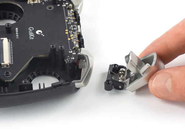

  19. GuliKit KingKong 2 Pro Daughterboard Replacement, Remove the right trigger: step 19, image 1 of 3 GuliKit KingKong 2 Pro Daughterboard Replacement, Remove the right trigger: step 19, image 2 of 3 GuliKit KingKong 2 Pro Daughterboard Replacement, Remove the right trigger: step 19, image 3 of 3
    • Repeat the previous procedure and lift the right trigger off its bracket to remove it.
