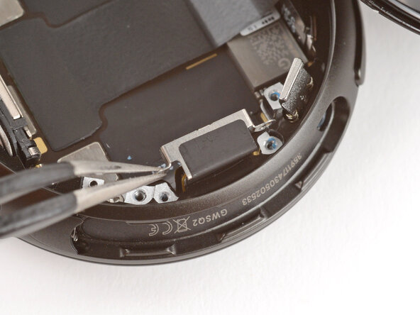

    1. Google Pixel Watch 5 Screen Replacement, Remove the vibration motor screws: step 7, image 1 of 2 Google Pixel Watch 5 Screen Replacement, Remove the vibration motor screws: step 7, image 2 of 2
      • Optionally, you can disconnect the back glass to give you more room to work—though you can complete the repair just fine with it still connected.
      • Use a Torx Plus 2IP screwdriver to remove the two 2.2 mm‑long screws securing the vibration motor.
      Ask FixBot
    2. Google Pixel Watch 5 Screen Replacement, Remove the vibration motor: step 8, image 1 of 2 Google Pixel Watch 5 Screen Replacement, Remove the vibration motor: step 8, image 2 of 2
      Ask FixBot
