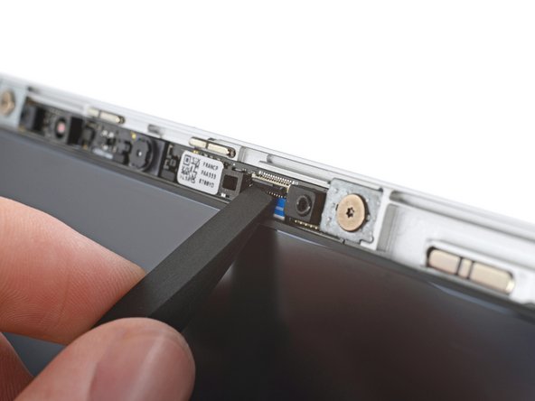

    1. Framework Laptop 16" Webcam Module Replacement, Disconnect the webcam module: step 4, image 1 of 2 Framework Laptop 16" Webcam Module Replacement, Disconnect the webcam module: step 4, image 2 of 2
      • Use the flat end of a spudger, or a clean fingernail, to lift up the locking tab on the webcam module ZIF connector.

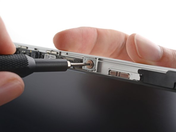

    2. Framework Laptop 16" Webcam Module Replacement, Remove the webcam module screws: step 5, image 1 of 3 Framework Laptop 16" Webcam Module Replacement, Remove the webcam module screws: step 5, image 2 of 3 Framework Laptop 16" Webcam Module Replacement, Remove the webcam module screws: step 5, image 3 of 3
      • Use a T5 Torx screwdriver to remove the two 2 mm‑long screws securing the webcam module.
      • The screws thread through metal brackets. If they come off with the screws, you can skip the next step.
      • During reassembly, support the screen frame with your other hand as you reinsert screws to prevent the laptop from accidentally tipping over.

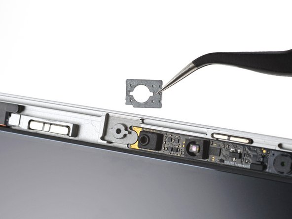

    3. Framework Laptop 16" Webcam Module Replacement: step 6, image 1 of 3 Framework Laptop 16" Webcam Module Replacement: step 6, image 2 of 3 Framework Laptop 16" Webcam Module Replacement: step 6, image 3 of 3
      Tool used on this step:
      Buy
      • Use tweezers, or your fingers, to remove the two metal brackets on both ends of the webcam module.

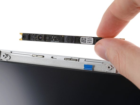

    4. Framework Laptop 16" Webcam Module Replacement, Remove the webcam module: step 7, image 1 of 3 Framework Laptop 16" Webcam Module Replacement, Remove the webcam module: step 7, image 2 of 3 Framework Laptop 16" Webcam Module Replacement, Remove the webcam module: step 7, image 3 of 3
      • Use tweezers to lift the right side of the webcam module until the cable slides out of the ZIF connector.
      • Remove the webcam module.

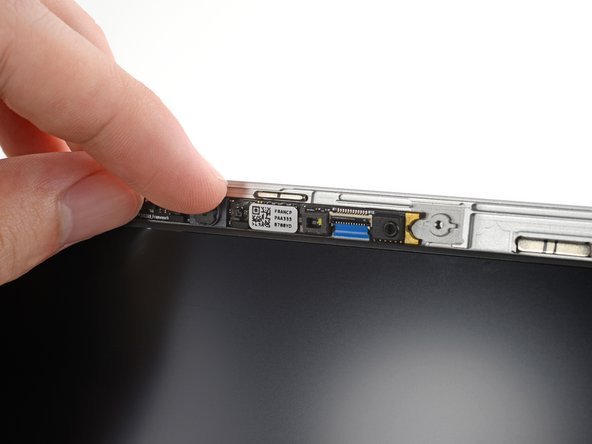

    5. Framework Laptop 16" Webcam Module Replacement, Reassembly information: step 8, image 1 of 3 Framework Laptop 16" Webcam Module Replacement, Reassembly information: step 8, image 2 of 3 Framework Laptop 16" Webcam Module Replacement, Reassembly information: step 8, image 3 of 3
      • Reconnecting the webcam module is a little tricky. If you're having difficulty, you can reposition the display to give the webcam cable more slack.
      • During reassembly, follow these instructions to reinstall a new webcam module:
      • Use tweezers to gently bend the webcam cable away from the screen frame.
      • Use your other hand to align the webcam module over the cable and lower it into place.
      • Make sure the webcam module sits level with the display before flipping down the cable locking tab and continuing reassembly.
