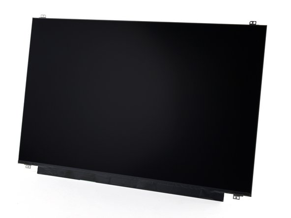

Use this guide to replace the display in your Framework 16" laptop.

      • Grab the display and pull it straight off the screen frame to free it from its alignment pegs.
      • Don't pull the display too far from the frame, as it's still attached by a cable.
      • Flip the front of the display down and rest it on the keyboard.
      Ask FixBot
    3. Framework Laptop 16" Display Replacement: step 6, image 1 of 2 Framework Laptop 16" Display Replacement: step 6, image 2 of 2
      • Use your fingers to flip up the plastic tab and access the connector underneath.
      Ask FixBot
    4. Framework Laptop 16" Display Replacement: step 7, image 1 of 2 Framework Laptop 16" Display Replacement: step 7, image 2 of 2
      • Use the flat end of a spudger to lift up the metal locking tab over the display connector.
      Ask FixBot
    5. Framework Laptop 16" Display Replacement, Remove the display: step 8, image 1 of 3 Framework Laptop 16" Display Replacement, Remove the display: step 8, image 2 of 3 Framework Laptop 16" Display Replacement, Remove the display: step 8, image 3 of 3
      • Grip the display cable where it meets the connector head.
      • Slide the connector straight out of its socket to disconnect it.
      • Remove the display.
