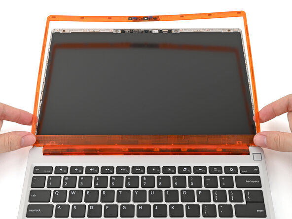

    2. Framework Laptop 13 Bezel Replacement, Remove the Bezel: step 2, image 1 of 2 Framework Laptop 13 Bezel Replacement, Remove the Bezel: step 2, image 2 of 2
      • The Bezel is secured with magnets.
      • Slide your fingernail under the inside edge of either bottom corner of the Bezel.
      • Pull the Bezel away from the screen to release the first few magnets.
      Ask FixBot
    3. Framework Laptop 13 Bezel Replacement: step 3, image 1 of 2 Framework Laptop 13 Bezel Replacement: step 3, image 2 of 2
      • Lift the Bezel around the perimeter of the screen until all of its magnets are released.
      • Remove the Bezel.
