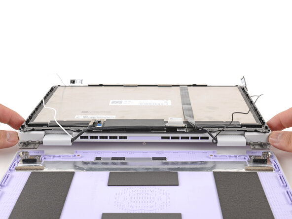

    4. Framework Laptop 12 Top Cover Replacement, Swing the display over: step 9, image 1 of 3 Framework Laptop 12 Top Cover Replacement, Swing the display over: step 9, image 2 of 3 Framework Laptop 12 Top Cover Replacement, Swing the display over: step 9, image 3 of 3
      • Use your fingers to carefully swing the display over so it lies on top of the keyboard.

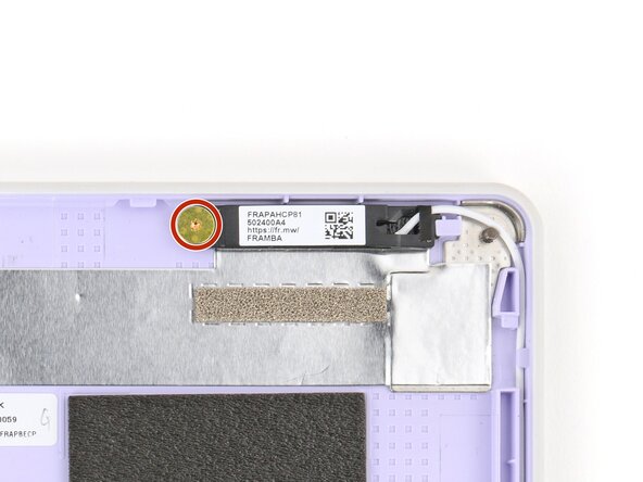

    1. Framework Laptop 12 Top Cover Replacement, Remove the antenna screws: step 10, image 1 of 2 Framework Laptop 12 Top Cover Replacement, Remove the antenna screws: step 10, image 2 of 2
      • Use your Framework Screwdriver to remove the two 2.4 mm‑long T5 Torx screws securing the two antennas to the Top Cover.

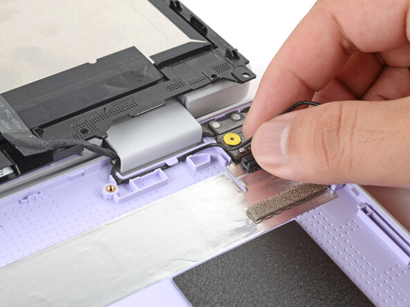

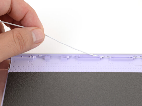

    2. Framework Laptop 12 Top Cover Replacement, Unthread the antenna cables: step 11, image 1 of 3 Framework Laptop 12 Top Cover Replacement, Unthread the antenna cables: step 11, image 2 of 3 Framework Laptop 12 Top Cover Replacement, Unthread the antenna cables: step 11, image 3 of 3
      • Use your fingers to lift the right antenna away from the Top Cover.
      • Carefully guide the white antenna cable out of its channel until you reach the hinge.
      Ask FixBot

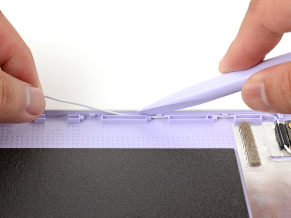

    3. Framework Laptop 12 Top Cover Replacement: step 12, image 1 of 2 Framework Laptop 12 Top Cover Replacement: step 12, image 2 of 2
      • Repeat the previous step to guide the black antenna cable out of its channel.

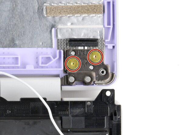

    4. Framework Laptop 12 Top Cover Replacement, Remove the hinge screws: step 13, image 1 of 2 Framework Laptop 12 Top Cover Replacement, Remove the hinge screws: step 13, image 2 of 2
      • Use your Framework Screwdriver to remove the four (two per hinge) 2.4 mm‑long T5 Torx screws securing the two hinges to the Top Cover.
      • These screws are not captive. Store them in a safe location for reassembly.

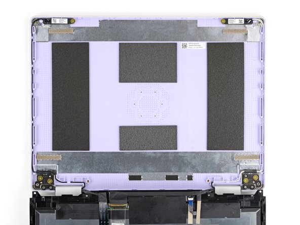

    6. Framework Laptop 12 Top Cover Replacement, Remove the Top Cover: step 15, image 1 of 1
      • Remove the Top Cover.
