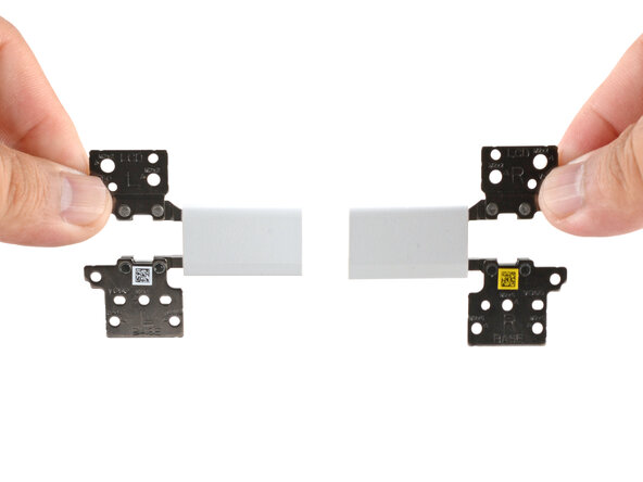

Follow this guide to remove and replace both hinges in your Framework Laptop 12.
If you can't get your laptop screen to hold in place due to loose hinges, you may need to replace them.

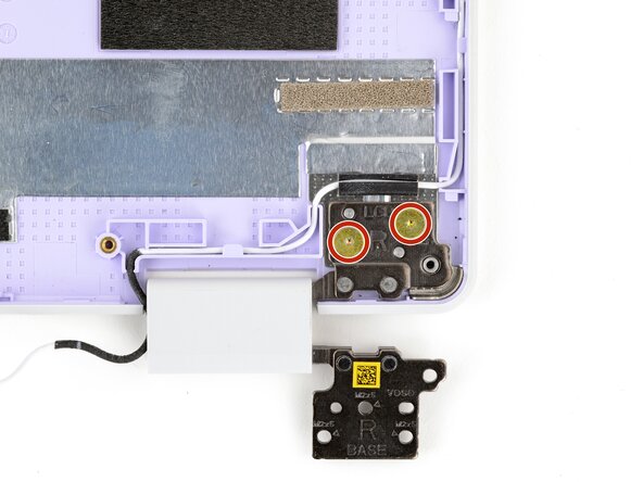

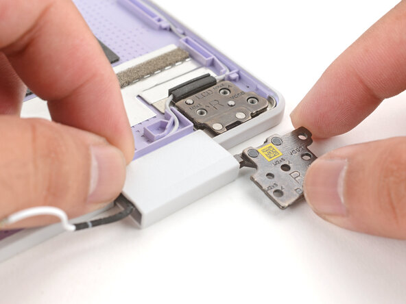

    4. Framework Laptop 12 Hinges Replacement, Bend the hinges up: step 34, image 1 of 3 Framework Laptop 12 Hinges Replacement, Bend the hinges up: step 34, image 2 of 3 Framework Laptop 12 Hinges Replacement, Bend the hinges up: step 34, image 3 of 3
      • Use your fingers to twist the right hinge plate until it's flipped on top of the display.
      • The stiff hinge can be difficult to twist. Wear some work gloves, or use a cloth to help get a better grip.
      Ask FixBot
    5. Framework Laptop 12 Hinges Replacement: step 35, image 1 of 3 Framework Laptop 12 Hinges Replacement: step 35, image 2 of 3 Framework Laptop 12 Hinges Replacement: step 35, image 3 of 3
      • Twist the left hinge plate until it's flipped on top of the display.
      Ask FixBot

    8. Framework Laptop 12 Hinges Replacement, Twist the hinge plates down: step 38, image 1 of 3 Framework Laptop 12 Hinges Replacement, Twist the hinge plates down: step 38, image 2 of 3 Framework Laptop 12 Hinges Replacement, Twist the hinge plates down: step 38, image 3 of 3
      • Use your fingers to twist both hinge plates back down so they lay flat on your work surface.
      Ask FixBot
    9. Framework Laptop 12 Hinges Replacement, Remove the display screws: step 39, image 1 of 1
      • Use your Framework Screwdriver to remove the four 3.3 mm‑long T5 Torx screws securing the display to the Top Cover.
      • These screws are not captive. Store them in a safe location for reassembly.

    1. Framework Laptop 12 Hinges Replacement, Remove the hinge screws: step 43, image 1 of 2 Framework Laptop 12 Hinges Replacement, Remove the hinge screws: step 43, image 2 of 2
      • Use your Framework Screwdriver to remove the four (two per hinge) 2.5 mm‑long T5 Torx screws securing the two hinges to the Top Cover.

    2. Framework Laptop 12 Hinges Replacement, Remove the hinges: step 44, image 1 of 2 Framework Laptop 12 Hinges Replacement, Remove the hinges: step 44, image 2 of 2
      • Lift and remove both hinges from the Top Cover.

    1. Framework Laptop 12 Hinges Replacement, Install the hinges: step 46, image 1 of 3 Framework Laptop 12 Hinges Replacement, Install the hinges: step 46, image 2 of 3 Framework Laptop 12 Hinges Replacement, Install the hinges: step 46, image 3 of 3
      • Lay both hinges in place in the Top Cover.
      • Use the alignment pins to help position each hinge in place.
