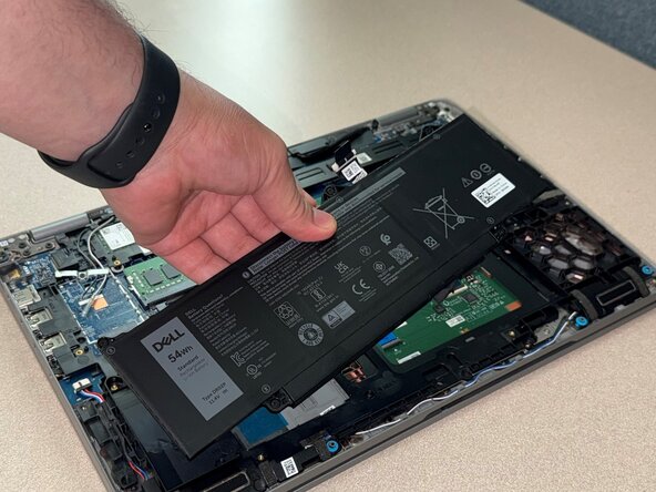

    3. Dell Precision 3580 Battery Replacement: step 3, image 1 of 1
      • Disconnect the battery connector from its motherboard port.
      Ask FixBot
    4. Dell Precision 3580 Battery Replacement: step 4, image 1 of 2 Dell Precision 3580 Battery Replacement: step 4, image 2 of 2
      • Remove all five Phillips screws securing the battery.
      • Lift the battery up and out of the chassis.
      Ask FixBot
    5. Dell Precision 3580 Battery Replacement: step 5, image 1 of 1
      • Flip the battery and peel the tape that holds its cable in place to remove it.
      • You will need the tape to secure this cable onto the new battery. It is best to not discard it after removal.
      • Disconnect the end of the cable connected to the battery so it can be moved to the replacement.
      Ask FixBot
    6. Dell Precision 3580 Battery Replacement: step 6, image 1 of 1
      • Connect the cable to your replacement battery.
      • Align the cable with the groove on the underside of the battery and secure it using the tape.
      Ask FixBot
    7. Dell Precision 3580 Battery Replacement: step 7, image 1 of 1
      • Install the replacement battery gently and replace all five of the screws that secure it in place.
      • Gently reconnect the battery connector to its motherboard socket.
      Ask FixBot
    8. Dell Precision 3580 Battery Replacement: step 8, image 1 of 1
      • Replace the lower case and fasten all eight of the screws to resecure it.
      Ask FixBot
For optimal performance, after completing this guide, calibrate your newly installed battery.
