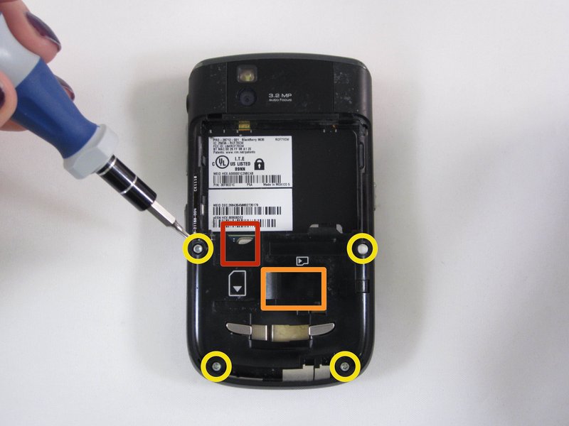

    1. BlackBerry Tour 9630 Keypad Replacement, Keypad: step 4, image 1 of 1
      • If there is an SD card, press gently on the card and slide it up to remove.
      • If there is a SIM card, press gently on the card and slide it left to remove.
      • Use the T6 Torx screwdriver to remove the four 8.00 mm screws from the back of the phone.
