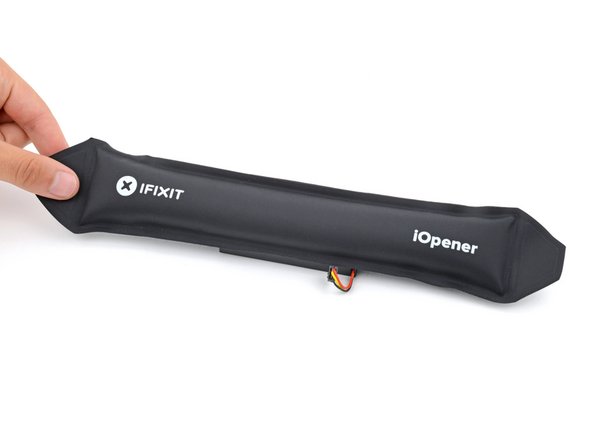

    1. Analogue Pocket Battery Cell Replacement, Heat the battery housing: step 6, image 1 of 3 Analogue Pocket Battery Cell Replacement, Heat the battery housing: step 6, image 2 of 3 Analogue Pocket Battery Cell Replacement, Heat the battery housing: step 6, image 3 of 3
      • Strong adhesive secures the battery cell to its housing.
      • Heat an iOpener and apply it to the top of the plastic battery housing for two minutes to soften the adhesive.
      • Alternatively, you can use a hair dryer to lightly heat the housing. But be careful, as the plastic can easily be warped.

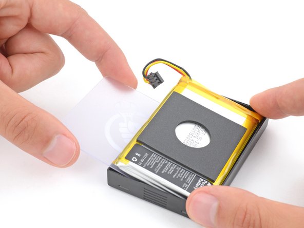

    2. Analogue Pocket Battery Cell Replacement, Separate the battery cell adhesive: step 7, image 1 of 3 Analogue Pocket Battery Cell Replacement, Separate the battery cell adhesive: step 7, image 2 of 3 Analogue Pocket Battery Cell Replacement, Separate the battery cell adhesive: step 7, image 3 of 3
      Tool used on this step:
      Plastic Cards
      $2.99
      Buy
      • Take care not to bend the battery—it can leak dangerous chemicals and/or catch fire.
      • Firmly secure the battery with one hand.
      • With your free hand, insert a plastic card between one of the long edges of the battery cell and its housing.
      • Pry up with the plastic card and apply steady pressure until a gap forms.
      • Be patient and allow plenty of time for the adhesive to separate. If you're having trouble creating a gap, apply more heat and try again.
      • Slide the card under the battery cell.

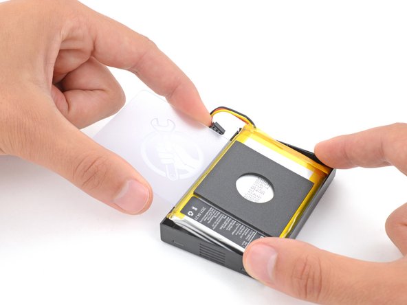

    3. Analogue Pocket Battery Cell Replacement: step 8, image 1 of 2 Analogue Pocket Battery Cell Replacement: step 8, image 2 of 2
      • Slide the plastic card back and forth under the battery cell to separate the adhesive.

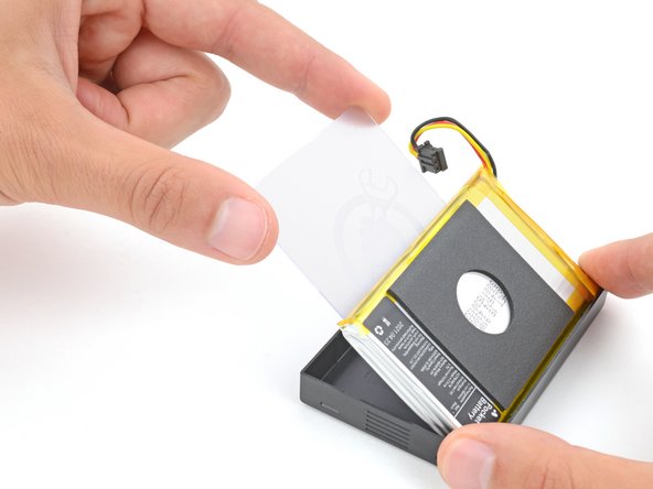

    4. Analogue Pocket Battery Cell Replacement, Remove the battery: step 9, image 1 of 3 Analogue Pocket Battery Cell Replacement, Remove the battery: step 9, image 2 of 3 Analogue Pocket Battery Cell Replacement, Remove the battery: step 9, image 3 of 3
      Tesa 61395 Tape
      $8.95
      Buy
      • Use the plastic card to lift the battery cell out of its housing and remove it.
      • During reassembly:
      • When installing a battery cell, make sure its cable goes into its cutout in the housing.
      • If your new battery cell comes with pre-installed adhesive, remove the plastic backing and firmly press the cell into place in its housing.
      • If your new battery cell doesn't have adhesive, use strips of double-sided tape such as Tesa Tape to secure it in the housing.
