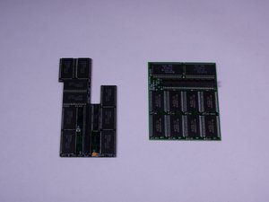

  • Memory: The PowerBook 165c came with 4 MB of RAM stock, and can be upgraded to have 14 MB of RAM. This 14MB RAM is a special 85ns PSRAM card from a third party.

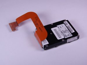

  • Hard Drive: The PowerBook 165c came in either a 80MB, 120MB, or 160MB hard drive. Users can install any of these hard drives.
