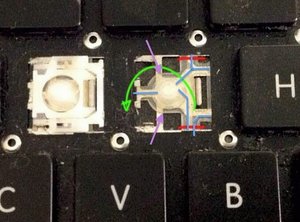

See my markup:
the blue lines are the wire traces you can not disturb.
your best bet is to separate the films where the purple arrows are; get a needle, or x-acto point between the three films of plastic; doesn't matter if between 1 and 2 or 2 and 3 layer. insert on both top and bottom where purple arrow are and then use a 'canned air' to blow the liquid out.
unfortunately there is a good chance that if a 'string' of keys are out, what has happened is that the trace is actually damaged between the layers, where it was 'glued' together.
I had over a dozen keys that didn't work properly but sometimes worked because milk got in there, and on the model of computer, the films were more solid, so i had to cut slits, but in your case, you can see the EDGE of the film sandwich, so you can peel them apart (they are glued), just enough to get an air blast in; if you pull too far you risk tearing the fragile silver trace .

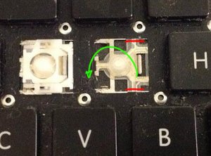

if the keys stick that is causing the problem, try to remove the key cap and clean it with alcohol.

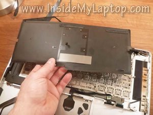

Here's an example of replacing just the keyboard on a MacBook Pro 15" Unibody (Mid 2010). It should be relatively similar for years 2009 and 2010.
Replacing keyboard on MacBook Pro 15" Mid 2010
You'll have to disassemble the notebook as it shown in one of the guides on iFixit and access the keyboard. After that you carefully remove the backlight and unscrew the keyboard.
