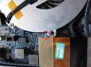

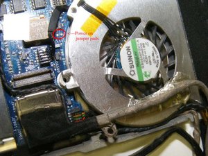

Thanks for the infos. So you have the white macbook 1181 2.4ghz.
Was the macbook top case disconnected from the logic board when the short occured ? If so I don't think it could be faulty. But to check this you could try to power on the machine by bridging the two power pads located just under the fan near the optical drive socket. Look for the power icon just over the two pads, top case most be disconnected, connect the ac adapter and bridge the two contacts with a small metallic flat screwdriver.
Let us know if the machine start.

There are 2 different variations of the jumper pads on the A1181. One is marked by the power on symbol and the pads are right below the icon. The other version is marked by PWR BTN and the pads are to the left of those letters. I believe the 2.4GHz has the PWR BTN version, I added a picture of it, just in case.
by
No, I have a 2.4 logic board and it shows a power icon.
by
Wow it has just atsrted up by bridging tghe power as you said. So it must be the keyboard then?
