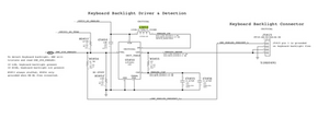

I have a Mid 2012 15” MacBook Pro. Suddenly the keyboard’s backlight is not working anymore.
I tried to:
  • reset the SMC
  • reset PRAM
  • format and reinstall macOS
The connector of the backlight seems ok, I tried to disconnect and reconnect it without success.
If I try to press F5 or F6, I see the illumination steps changing on the animation correctly but the keyboard is dark. I also tried to disable auto-regulation in settings.
Is it possible that the connector disconnected from the keyboard part?
If it is a hardware problem is it possible to substitute some parts to make it work again?
Thanks
Update (01/04/2021)
Hi! I have some updates.
I changed the keyboard because some keys started to not work.
Now the keyboard is working fine but the backlight is still not working. Opening my Mac, I noticed that a little component in front of the backlight connector is damaged (I attach a picture). Could be this the cause of the problem? There is a solution to repair it?

Update (01/04/2021)
Here’s the info for your second problem!
You have a damaged Inductor L5850 which is 10UH 0.58A / 350 Ohm, part ID 1098AS-SM
You’ll need to talk to talk with TDK or other inductor maker to find a source I couldn’t find it in Mouser. The only other option is finding a junker systems to salvage the part.
