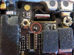

I have got an iPhone that i have just repaired (very badly damaged digitiser/LCD) and during testing i have realised the camera function has stopped working. When i open up the camera app, the rear camera loads and works, however when i switch to the front camera, the "retina" stays closed and the "camera-video" switch on the bottom right starts to flicker.
After that happens i am totally unable to use the camera function unless I disconnect the battery completely and reset the iPhone. This isn't the first iPhone this has happened to. It is not a firmware issue as i have restored it several times, and i am also aware that due to the iPhone being damaged this could also be the cause. Just want to know if there is a fix for this issue?

This will solve your problem! Everyone behold the long awaited mystery now revealed!
After countless hours of research, diagnosing and frustration i have finally found the reason as to why this happens. All credit goes to jamesjerss from gsmindia for this solution.
Below are two images of a very small capacitor responsible for the correct functionality of the iPhone.
Functional Capacitor (working camera)
Non-Functional Capacitor (non working camera)
jamesjerss Photo
Now the reason that you will get a faulty camera every once in a while is because this capacitor has become eroded over time, making it more susceptible to damage when you are removing the connection above it (evident in picture above for non working capacitor). As you can see there is a lot of dust/debree inside the phone. Your only solution is to re-solder that capacitor or get the entire iPhone replaced. Hope this helps guys!

Martin,
Great info! In case the solder pads are gone you can also create a new jumper using thin gauge wire on these two alternate contact points shown in this picture:
Cheers

i had a broken corner in one of the resistors shown in stellarola picture.
how to identify the resistor? check the picture, is writeen LONDANGSM written in green. (thanks stellarola and londangsm people!)
The resistor i had with a corner pad broken,
is just the black little scuare with 4 pads each side, 10 in total.
under the A letter from word LONDANGSM written in green.
i friend using a microscope made a jumper.
i had upper left corner pad broken from that resistor.
he did a jumper from the right upper pad to my broken one.
back camera is now fully working again.
all the thaks are for you people.
you are just great.
hope it helps.
have fun!

Hello,
If you can solve the pb by shorting on the two connections, i think it's not a capacitor but a coil or a jumper ! ??

I confirm : it'is a coil (z# 0.2 ohm).
Firstly, the resoldering was no good.
So, i have replaced the coil by a thin, short wire, cut after soldering for more conveniance.
Thanks for your help.

Yes, I talk about the very small component, close to the connector, shawn up this topic.
In the earlier comment, I explain that is a coil (z#0.2 ohm), probably to filter the front camera power supply ?
Firstly, I tried to re-solder this component, broken when changing the tactile-display screen block, but the front camera did'nt work properly.
So, yesterday, I have replaced this coil by a small, thin coper stapp, finaly, easier for soldering than the component !
Now, the front camera works correctly (after powered on/off the iphone).
