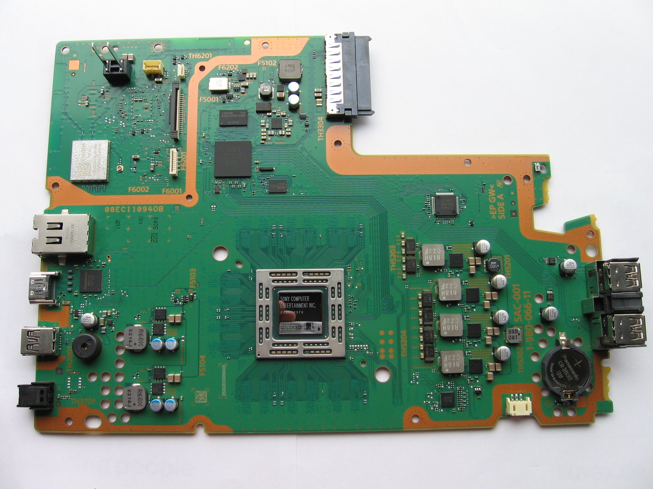

I am currently in the process of fixing a ps4 sac-001 board which another repair shop has made a mess of with a bodged hdmi replacement and i noticed that the ic what drives the optical audio is missing of the board. I don’t have any donor boards to get the part of it does anyone know what part it is?

The area you have marked does not have an IC there by default. Look at this image for example:
https://3.allegroimg.com/original/0c5c4a...
