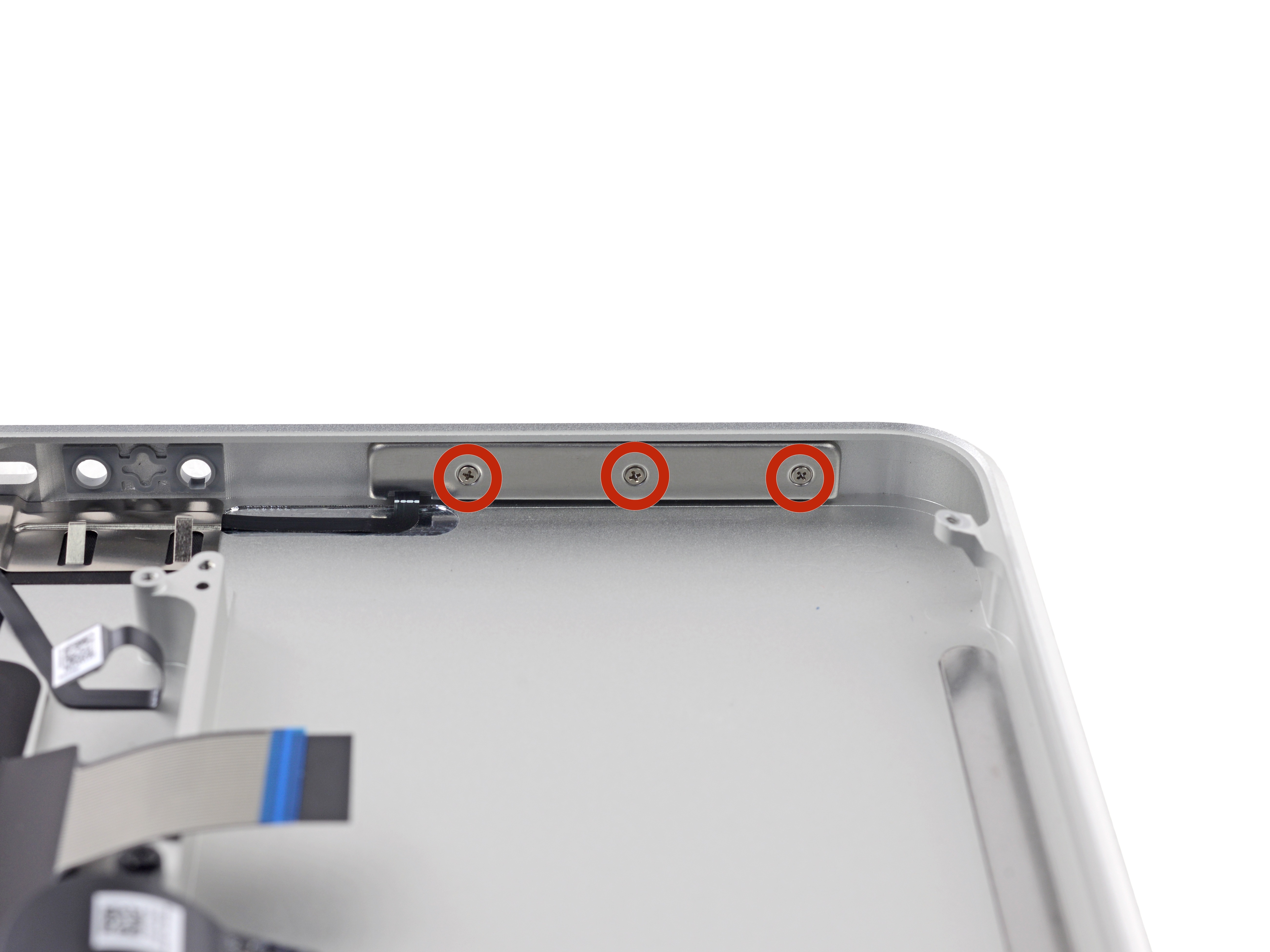

Also take the time to check the battery tester ribbon cable and connector which is the next step here in the guide. Unlike the backlight connection this is a plug-in. After unplugging it try see if a slightly moistened cotton swab (Q-Tip) with a high grade isopropyl alcohol (85% or better) around the test button. Let it dry and then reconnect the connector. Once you get things back together see if the battery tester works if not you'll need to replace it. To get to it you'll need to take the battery out. Here's a image of the 15" model which is the same Battery tester
