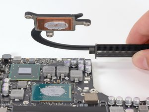

I did make the change yesterday. inside it has a thermal pad, that appears to be 3mm or less. i try to clean on my best. I make a making a very tick pea size and added again. but i have no idea if it works or not. still having temps on 56c on idle. there is no much info on that. i use MX-4 from arctic. but i still, in my option, a little to for my use. if someone have more info on that part on the late 2011 i7 macbook pro 13inch please send the info.
I did and applied Arctic Silver 5 underneath instead of the crap tape they put under there. This alone stopped the random freezing and rebooting problem I was having with this macbook pro. I recommend if you're already that deep into it, you might as well do it. I'm glad I did.

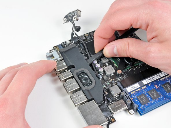

De-route the microphone cable from its slot molded into the left speaker enclosure.

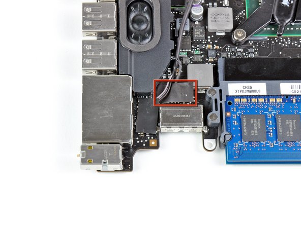

Remove the small piece of black tape covering the left speaker connector.
Use the flat end of a spudger to pry the left speaker connector up from its socket on the logic board.
Carefully pry the left speaker off the foam adhesive securing it to the logic board.
Remove the left speaker.

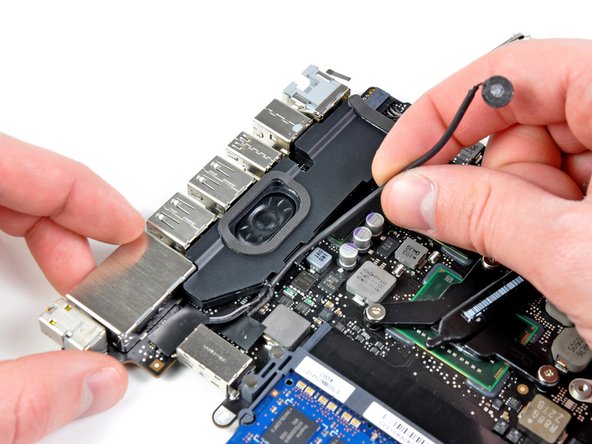

Remove the piece of black tape covering the microphone connector.
Pull the microphone cable upward to lift its connector out of the socket on the logic board.
Remove the microphone.

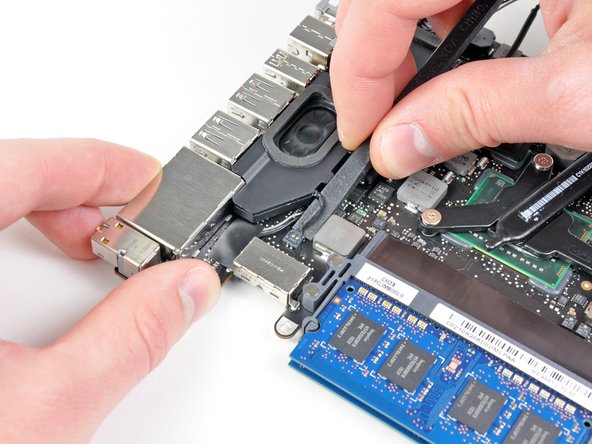

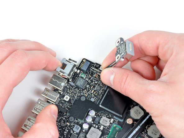

Pull the MagSafe DC-In board cable toward the heat sink to disconnect it from the logic board.
Remove the DC-in board.

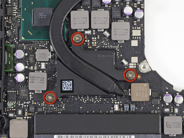

Remove the three 8.4 mm #1 Phillips screws securing the heat sink to the logic board.
Carefully remove the heat sink from the processor.

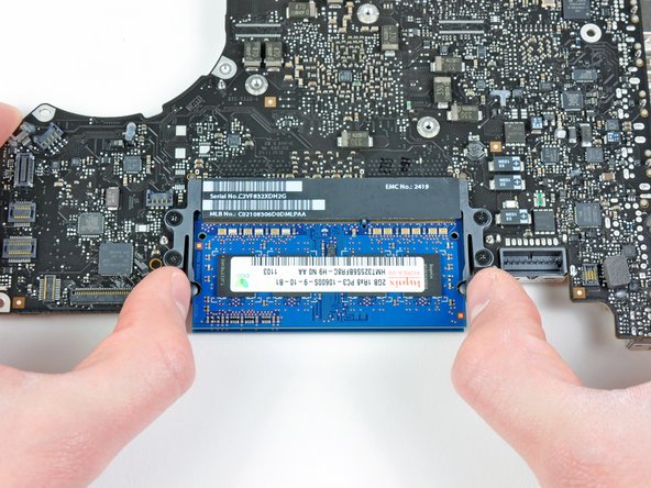

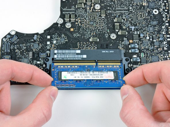

Pull the two RAM retaining arms away from the center of the RAM chip.
Pull the RAM stick out of its socket.
Logic board remains.
