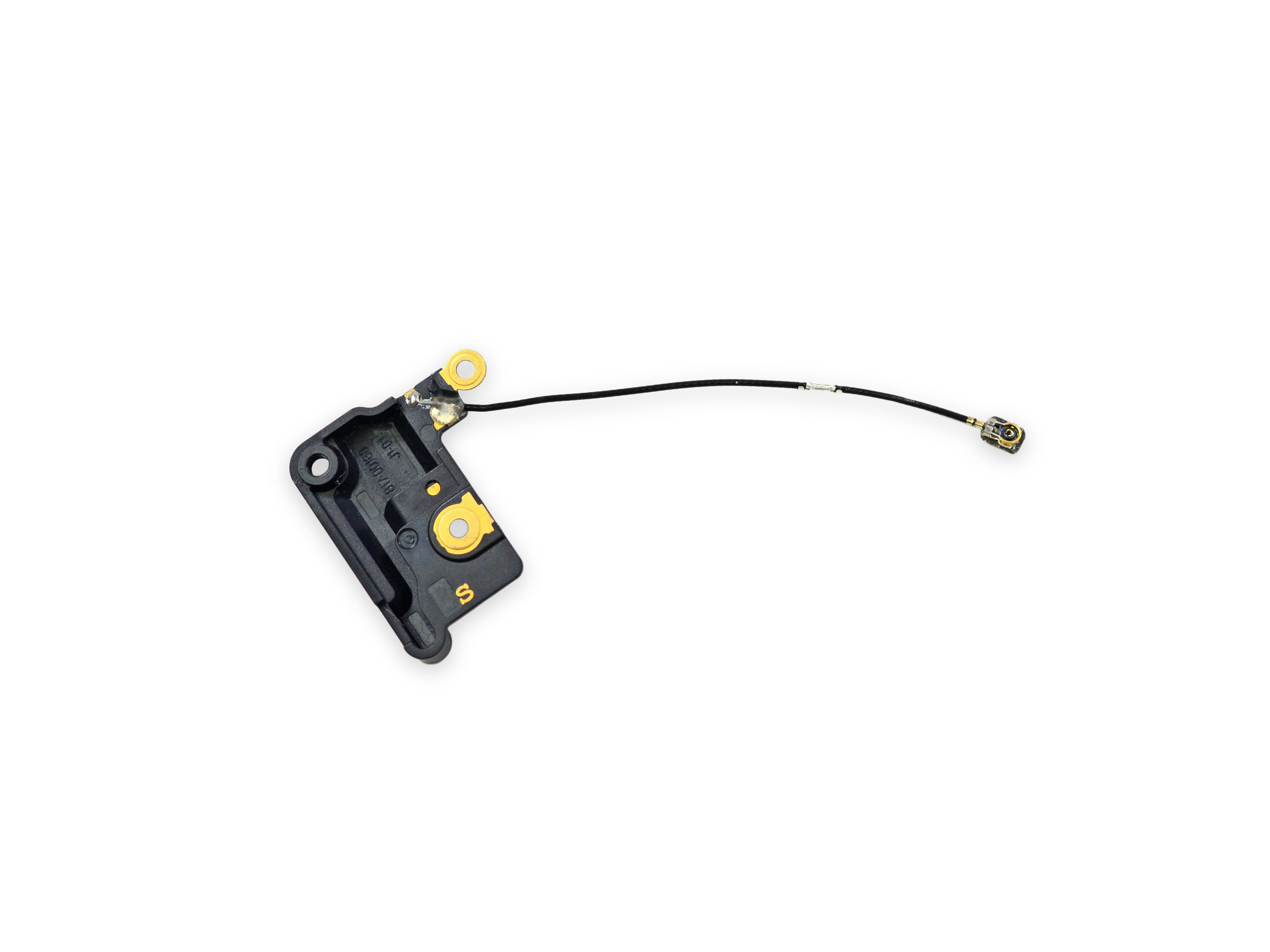

Just worked this out, this is for iPhone 6, however iPhone 6 plus should be similar.
The NFC antenna is the top bezel itself, the top bezel has 2.4G(wifi and Bluetooth), cellular diversity, GPS and NFC. The main feed point for GPS, cellular and 2.4G is the screw boss under the plastic add-on antenna, with a "grounding bracket" attaching it to the bezel. The plastic antenna serves as the 5G wifi antenna.
The NFC antenna feed point is the screw boss next to the camera and sleep/wake button, with a flex cable under the camera bracket serving as signal conductor.
There is an additional feed point in the middle of the bracket, it does not connect to any wireless services, however it connects to a dynamic switch to tune the top bezel dynamically to serve different bands.
The F-shaped flex cable on the back of the board is JUST a bridging cable, not an antenna in any way.

"The main feed point for GPS, cellular and 2.4G is the screw boss under the plastic add-on antenna, with a "grounding bracket" attaching it to the bezel. " Do you have any picture to describe this?
by
iPhone 6 logic board replacement guide, step 29.
by

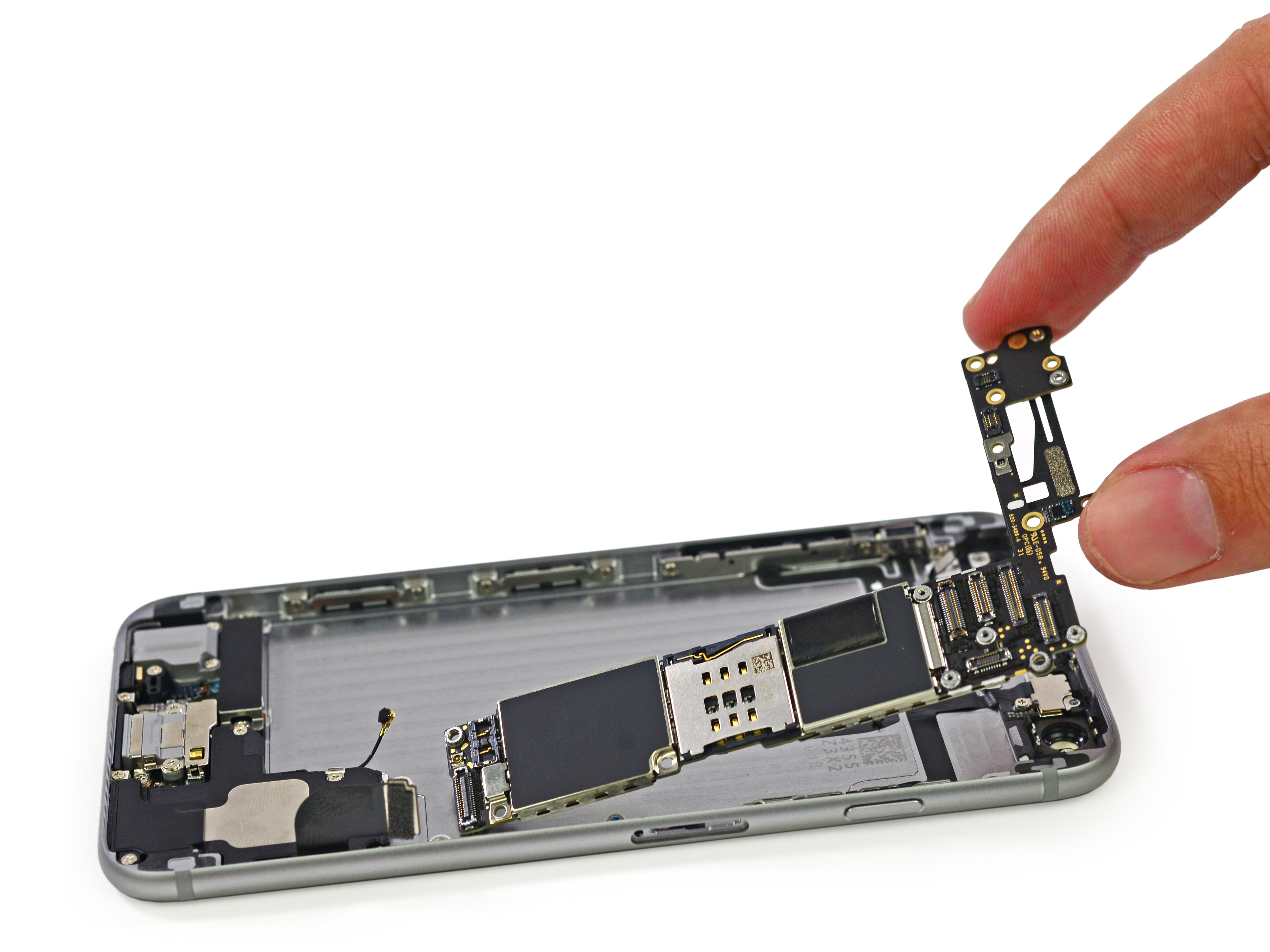

The entire top metal band and associated flex cables are a complex antenna assembly, I'm still trying to figure out which part serves NFC.

Here's a good image of the iPhone 6 logic bd. between the fingers is the NFC antenna iPhone 6 here in the iPhone 6 Plus the antenna clip its self holds the NFC antenna iPhone 6 Plus
by
Well, to me the oddly shaped flex cable is just like the RF flex cable on iPhone 5 logic board. Maybe it's just a conductor, bridging the signals. The actual antenna is somewhere else.
On the logic board there are some contact pads and screw bosses that are obviously connected to the circuit, those are antenna outputs i think.
Also Apple has this patent: Communications device and method for having integrated NFC antenna and touch screen display. US 8718553 B2. Maybe it is implemented but I'm not sure. Now we can only wait for someone to leak the circuit diagram online and further analyse it then.
