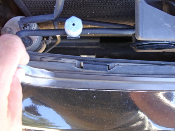

  3. 1998-2002 Honda Accord Headlights Replacement, Front Bumper: step 3, image 1 of 2 1998-2002 Honda Accord Headlights Replacement, Front Bumper: step 3, image 2 of 2
    • Locate and remove the bolts in the front of the wheel well on the either side of the car using a #1 Phillips screw driver or an 8 mm socket wrench.
    • Locate the bolts on the bottom of both corners of the bumper and remove them using an 8 mm socket wrench or box end wrench.

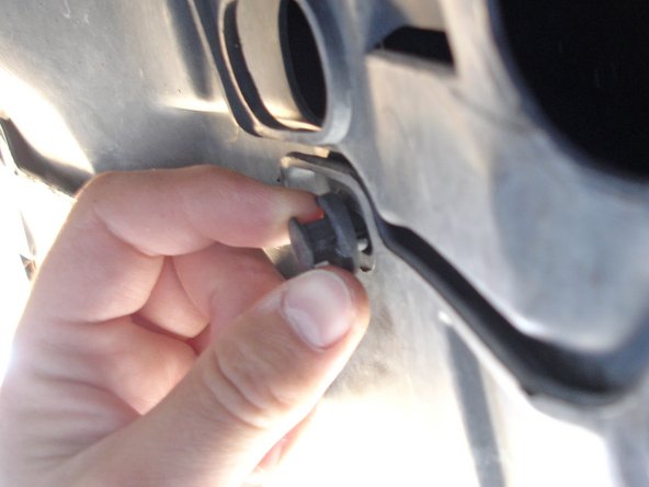

  4. 1998-2002 Honda Accord Headlights Replacement: step 4, image 1 of 3 1998-2002 Honda Accord Headlights Replacement: step 4, image 2 of 3 1998-2002 Honda Accord Headlights Replacement: step 4, image 3 of 3
    • Locate the plastic push pins along the bottom of the bumper.
    • Use a small thin prying device, such as a flathead screwdriver, to pop the heads of the push pin up. Then remove the entire push pin assembly from their holes.

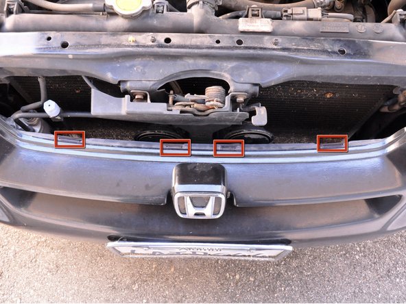

  5. 1998-2002 Honda Accord Headlights Replacement: step 5, image 1 of 3 1998-2002 Honda Accord Headlights Replacement: step 5, image 2 of 3 1998-2002 Honda Accord Headlights Replacement: step 5, image 3 of 3
    • Remove the push pins on the two raised portions of the bumper next to the inside of the headlights.
    • There are four clips along the top of the bumper still holding it in place. Gently lift the bumper while pulling it away from the car to free the clips and remove the bumper.

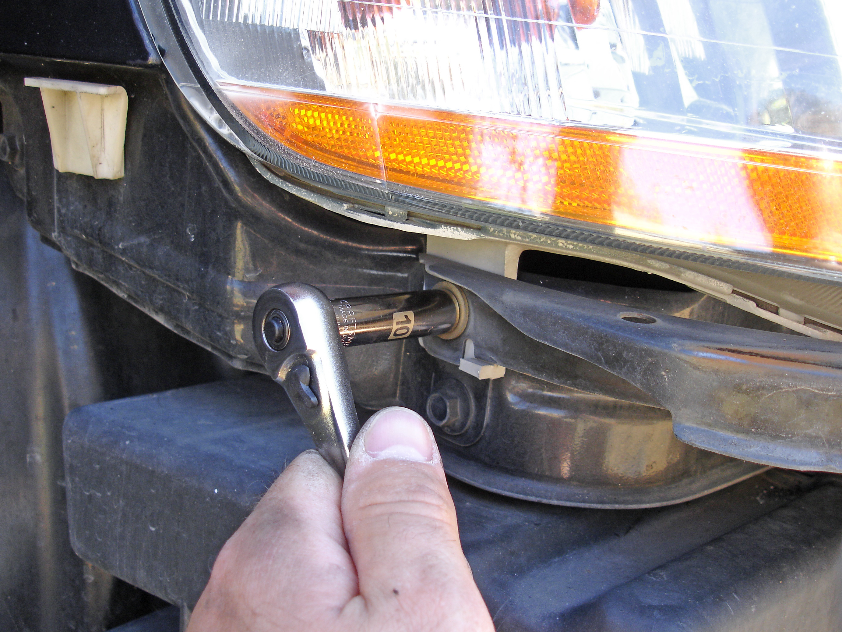

  6. 1998-2002 Honda Accord Headlights Replacement, Headlights: step 6, image 1 of 3 1998-2002 Honda Accord Headlights Replacement, Headlights: step 6, image 2 of 3 1998-2002 Honda Accord Headlights Replacement, Headlights: step 6, image 3 of 3
    • Remove the three 10 mm hex bolts securing the headlight bracket by turning them counter-clockwise with either a socket wrench or box end wrench,
    • One bolt will be under the outer edge of the headlight. The remaining two bolts will be located under the headlight with the bolt heads pointed towards the side panels.
    • Remove the headlight bracket by pulling it straight out.

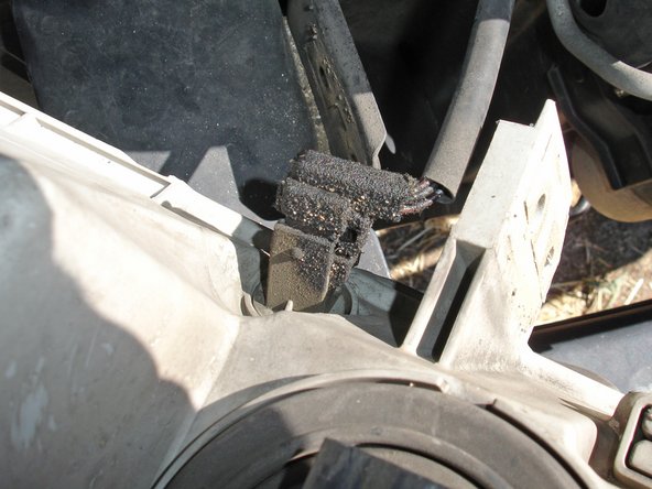

  8. 1998-2002 Honda Accord Headlights Replacement: step 8, image 1 of 2 1998-2002 Honda Accord Headlights Replacement: step 8, image 2 of 2
    • Remove the 10 mm bolt on top of the headlight using a socket wrench or box end wrench.
    • Remove the metal clip.
    • Pull the headlight straight away from the car.
    • Do not attempt to fully remove the headlight. There is still one connection left.

I don't see how you could get it out WITHOUT removing bumper. I have scoped it out on my 01, and it sure looks like the bumper gets in the way of getting to the bolts underneath the light.
sara - Reply
