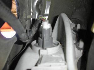

Locate the blinker light bulb assembly, it will be accessible from below the headlight, near the wheel well.
Disconnect the connector or remove the light bulb assembly by turning it counter-clockwise and pulling it out.
