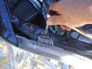

Remove the 10 mm bolt on top of the headlight using a socket wrench or box end wrench.
Remove the metal clip.
Pull the headlight straight away from the car.
Do not attempt to fully remove the headlight. There is still one connection left.
