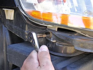

Remove the three 10 mm hex bolts securing the headlight bracket by turning them counter-clockwise with either a socket wrench or box end wrench,
One bolt will be under the outer edge of the headlight. The remaining two bolts will be located under the headlight with the bolt heads pointed towards the side panels.
Remove the headlight bracket by pulling it straight out.
