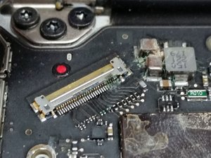

Standard Type
The type you will find most often on electronic devices is a white sticker that turns bright red or pink when it has contacted liquid. Some will have purple hatches or "x" marks that similarly turn red or pink.
Untriggered Standard LCI
Triggered Standard LCI
Ultra Violet Light Type
Apple upped the ante in more recent years, changing their stock indicator stickers for MacBooks to ones whose status is only visible under UV light.
Untriggered UV CLIs
UV LCI in normal light
UV LCI under UV light
Triggered UV LCIs
Triggered UV LCI in normal light
Triggered UV LCI under UV light
