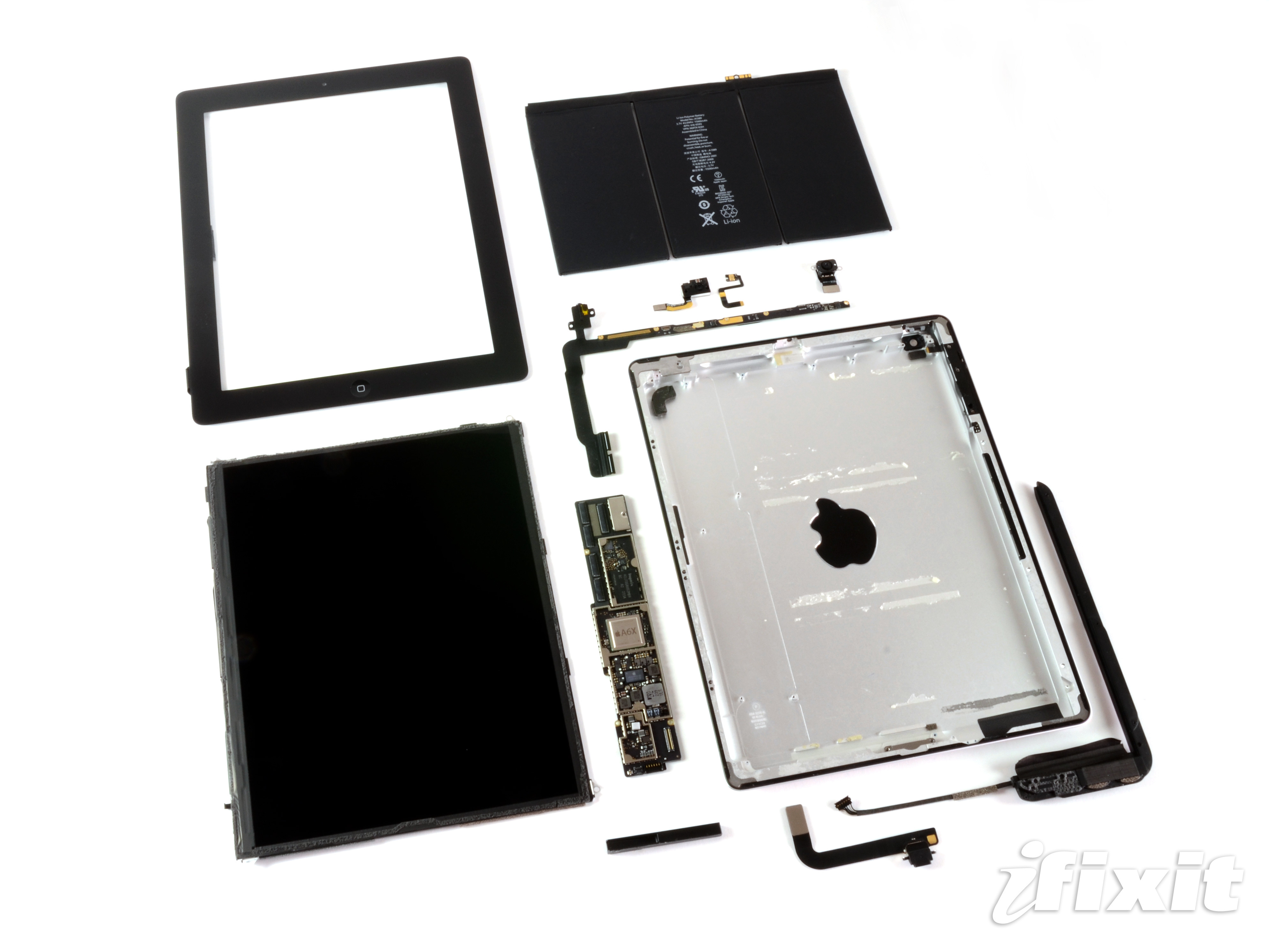

We got our hands on the fourth generation of iPad; we shall call it iPad 4. The iPad 4 is kind of like a fourth book added on to a trilogy: its release was a bit sudden and unexpected, but it's a part of the group, nonetheless. This fourth iteration of iPad shares a lot of similarities with the previous version, so instead of our traditional, exploratory teardown, we're going to play "spot the differences" by illustrating all the changes from the last generation.

Continuing the trend, this iPad is glued shut. This isn't our first adhesive-riddled iPad, and we've been working to figure out how to make the painful opening process a lot easier.
  • Continuing the trend, this iPad is glued shut. This isn't our first adhesive-riddled iPad, and we've been working to figure out how to make the painful opening process a lot easier.
  • Our heated-up iOpener lets us apply heat just where it's needed, softening the troublesome adhesive. Once we've snuck a few guitar picks in the seam, we're nearly home-free.

iPad 4 Repairability Score: 2 out of 10 (10 is easiest to repair) The LCD is easy to remove once the front panel is gone.
  • iPad 4 Repairability Score: 2 out of 10 (10 is easiest to repair)
    • The LCD is easy to remove once the front panel is gone.
    • The battery is not soldered to the logic board, making the replacement process a tad less difficult.
    • Just like in the iPad 2 & 3, the front panel is glued to the rest of the device, greatly increasing the chances of cracking the glass when trying to remove it.
    • Gobs, gobs, and gobs of adhesive hold everything in place, including the prone-to-start-a-fire-if-punctured battery.
    • The LCD has foam sticky tape adhering it to the front panel, increasing chances of it being shattered during disassembly.
    • You can't access the front panel's connector until you remove the LCD.
