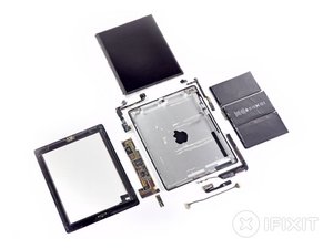

  • Finally!!! The iPad has come back to iFixit! And this time, it has a 2 at the end of its name, hence the iPad 2!
  • After a much awaited debut, the iPad 2 is expected to fill in the gaps left by the first generation iPad.
  • Tech Specs:
    • 1 GHz Apple A5 dual-core processor
    • 512 MB of LPDDR2 RAM
    • 16/32/64 GB internal storage capacity
    • 9.7" LED-backlit glossy Multi-Touch display with IPS technology (1024 x 768)
    • HD (720p) Rear-facing camera + VGA Front-facing camera

  • Without further ado, let's begin tearing this iPad 2 apart!
  • Unlike the original iPad, it looks like we need the help of a handy dandy heat gun to remove the front panel.
  • With the adhesive loosened after a healthy dose of heat, we go to work on prying up the front panel with a plastic opening tool.
Image #1
Edit Step 5  ¶
  • And just like that, it's open. No clips, just tons of glue.
  • As much as we hated trying to remove the clips in the original iPad, this much adhesive is even more of a pain. Be ready to crack your front panel if you dare open it! We'll be investigating the best way to get inside over the next few weeks.

  • Lifting off the LCD exposes the iPad 2's battery; A 3.8V, 25 Watt-hour unit. That's just a hair more than the original iPad's 24.8 Watt-hours, so any improved battery performance can be attributed to software and other hardware improvements.
  • Also listed on the battery is a capacity of 6930 mAh, which may appear to contradict the already mentioned 25Wh at 3.8V ((25Wh/3.8V)*1000=6579 mAh), but 3.8V is the listed nominal voltage, not the average voltage. The average voltage of the battery over a full charge/discharge is closer to 3.6V leading to a more accurate calculation ((25Wh/3.6V)*1000=6944 mAh).
  • After disconnecting its cable, the display can be removed from the iPad 2.

  • After popping off a few EMI shields, we get a good look at the ICs on the logic board. They include:
    • Broadcom BCM5973KFBGH Microcontroller used for touchscreen
    • Broadcom BCM5974 CKFBGH capacitative touchscreen controller
      • This is the same combination as the original iPad - nothing new here!
  • Interestingly, the Wi-Fi board is attached to the logic board under one of the EMI shields. It can be easily pried off its socket.
Image #1
Edit Step 12  ¶
  • The Wi-Fi board; powered by another Broadcom chip, a BCM43291HKUBC. Broadcom has made this Wi-Fi/Bluetooth/FM tuner combo chip a ubiquitous part for smartphones - lots of design wins.
  • This is the same part Apple used in both the first iPad and the iPhone 4.

  • Notable chips found on the logic board (click here for mega size):
  • Apple 1GHz A5 dual-core Processor with a 200MHz bus and 512 MB of Samsung manufactured RAM.
  • Toshiba TH58NVG7D2FLA89 16GB NAND Flash
  • Apple 343S0542 - this looks like the Dialog Semi power management chip found in last year's iPad - all of those inductors and capacitors surrounding it are a clue.
  • Texas Instruments CD3240B0 11AZ4JT G1 touchscreen line driver, working with the Broadcom BCM5973 and BCM5974 chips shown above.
  • S6T2MLC N33C50V Power Management IC
  • The A5 processor has manufacture dates of late January and mid-February 2011. Production was clearly ramping up through the last minute. It looks like the A5 processor is the APL0498, replacing the A4/APL0398 seen in the iPad 1 and iPhones.
  • Apple-branded 338S0940 A0BZ1101 SGP. This looks like the Cirrus audio codec Chipworks found in the Verizon iPhone, but they'll have to get it off the board to make sure.

  • iPad 2 Repairability Score: 2 out of 10 (10 is easiest to repair)
  • The LCD is really easy to remove once the front panel is gone.
  • Only standard Phillips screws were used -- no Pentalobular or Tri-Wing funny-business.
  • The front panel is now glued to the rest of the device, greatly increasing the chances of cracking the glass when trying to remove it.
  • The LCD has foam sticky tape adhering it to the front panel, increasing chances of it being shattered during disassembly.
  • The battery is very securely stuck down to rear case, and you have to remove the logic board to remove it.
  • You can't access the front panel's connector until you remove the LCD.
  • Historical note: We initially awarded the iPad 2 a 4 out of 10, but in the process of writing our repair manual realized that it was far more difficult to repair than originally suspected.
