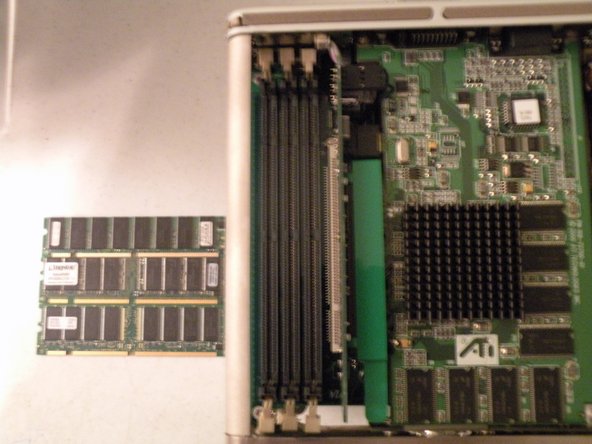

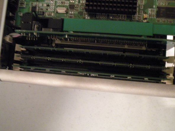

    • Removing the Ram
    • Start by fliping the cube so that the side with the graphics card is facing you, you may want to push the handle back in.
    • There are 3 RAM Slots, they are Standard PC100 Ram. The cube can support up to 1.5GB of ram, that's a 512MB Stick In All 3 Slots.
    • Remove the ram, just like any other kind of ram.

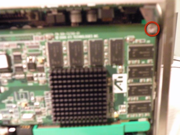

    • The Graphics Card
    • The Cube came standard with a Mac ATI Rage 128 Pro 16MB AGP Card. ATI Radeon (32MB) and nVidia GeForce 2MX (32MB) cards were BTO options.
    • There are few Cube compatible mac cards, due to the cube's small size, heat dissipation limitations, and limited power supply capabilities.
    • Remove these T10 screws:
    • Then, pull the top piece of metal off of the computer,
    • There is a small fragile cable coming from the top if the cube for the power button/LED, before fully removing the piece, unplug this cable from the logic board.

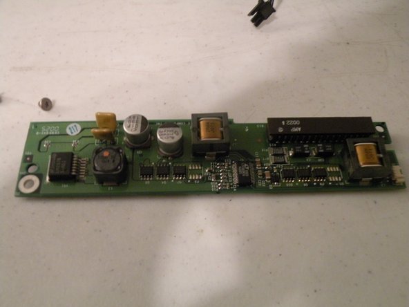

    • Removing the Voltage Regulator Module.
    • This board is called the DC/DC board, or the Voltage Regulator Module. It takes the power from the power brick and regulates the power to different components of the Cube.
    • First, disconnect the power connector.
    • Then release the white clip on the connector socket, which is accessed from the side of the core.
    • With a little persuasion, the board comes out of it's socket(it's hard to show how the board comes out, but in person, it's pretty self explanatory)
