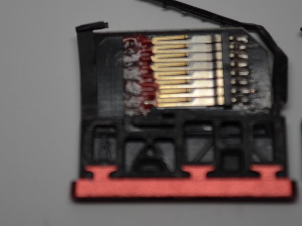

    • Once you remove the top case you will have to remove the aperture chip, which is very tricky and requires an amount of pulling and, for me, some breaking of the back paneling along the top. The Chip is set into the plastic at the base of the card

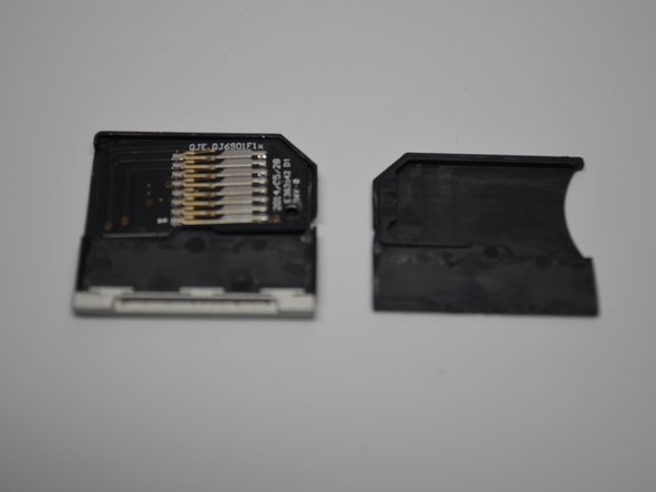

    • Removing the end-cap at this point is easy. Nifty's redesigned cap and mold make for easy end-cap removal, after front and rear plastic molds are separated. This requires no force.
    • Now the card is completely torn down into 4 parts
    • *Front Plastic Mold, *Rear Plastic Mold, *End-Cap *Adapter Chip

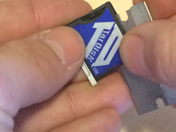

    • TarDisk Teardown is similar to Nifty TearDown. The sonic weld is on the front edges of the card. Work a razor blade or Xacto knife along the weld from cap to MicroSD port opening.
    • Next Run blade along top weld and right side. Last run blade down between the front and back plastic to break weld at bottom that holds end-cap in place.
    • End-cap pops out of mold same as Nifty. Adapter Chip should lift easily out of its mold with little resistance.

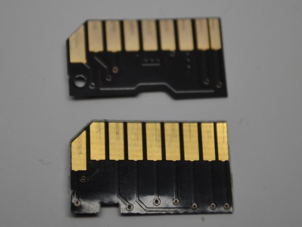

    • Top MicroSD to SD Adapter Chip = TarDisk. Bottom MicroSD to SD Adapter Chip = Nifty.
    • The Nifty MiniDrive chip has a red glue substance. And a square shape cut up into bottom, this seats the chip in place in the plastic mold
    • TarDisk Chip on top in both images has a circular hole cut into the bottom right end the card sits in a shaped plastic bottom mold and is additionally secured in place by this hole and a small plastic peg in the mold.
    • Chips back side (verso) Top Chip TarDisk, bottom chip Nifty, both use gold for a faster connection. Read&Write speeds are about the same using the same chip and computer. TarDisk is slightly more responsive but is also newer. The Nifty Card for this test was also purchased new but was not built as recently.

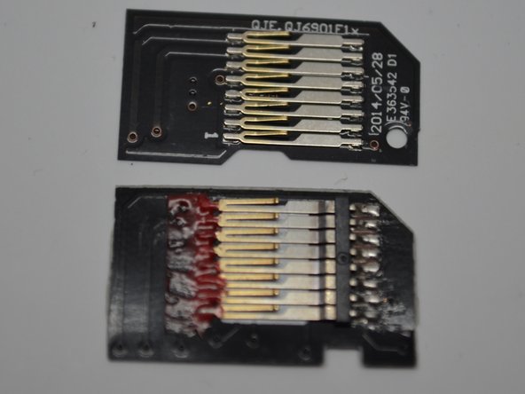

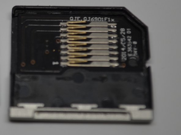

    • I am surprised at how much neater and cleaner the TarDisk's AdapterChip is.
    • The red substance used on Nifty's circuit board (red circle) is an epoxy used instead of a clean solder. The connection points (in the red rectangle) look poorly soldered and dismal looking compared to the TarDisk's and appears unstable against the TarDisk's cleaner chip construction.
    • This red Epoxy can only add to the reported unreliability and instability of the Nifty MiniDrive.
