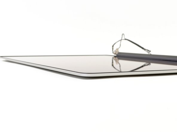

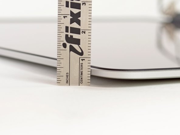

    • Would you call us crazy if we told you that the display assembly from the latest MacBook Pro is the same size as its predecessor?
    • You caught us; we lied. The new display is actually a fraction of a millimeter smaller than the old one. Neat!
    • At its fattest point, the display assembly is a hair over 7 mm thick, and all the way down to just over 3 mm at the edges.
    • What's astounding is that Apple's engineers managed to cram four times the pixels of the previous 15" MacBook Pro into a display assembly that is (nearly) the same size.
    • The big savings here is weight, not thickness. The Retina display weighs in at 673 grams, while a standard 15" MacBook Pro display tips the scale at 908 grams. That's a solid 25% weight savings!

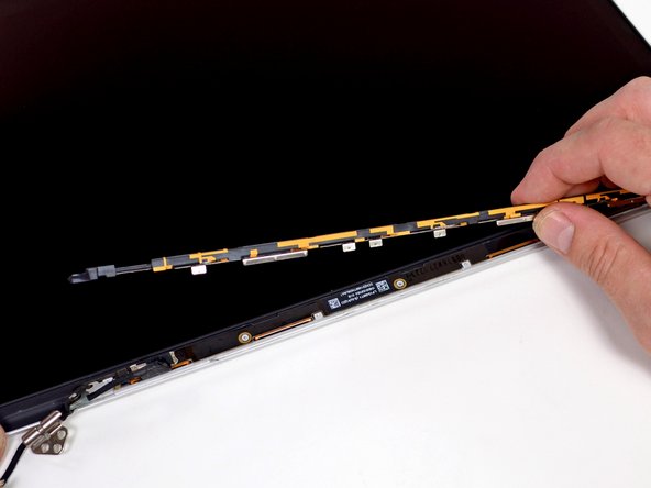

    • The disassembly begins pretty routinely. Like most Apple laptops, the clutch cover pries off fairly easily with a plastic opening tool.
    • But differences start popping up as soon as the clutch cover comes off. The array of antennas underneath the clutch cover looks a lot more involved than in previous generations.

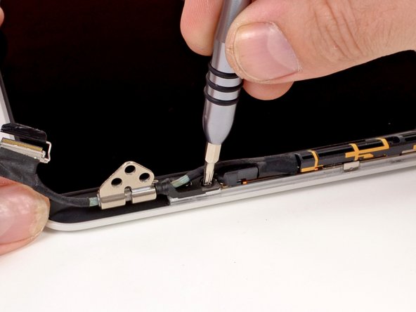

    • The left display hinge comes out with no issues, but good luck separating it from the display data cable.
    • Devices with cables fed through hinges can be a real bear to work on. None of that will be an issue with this machine, though, as the display hinge is pretty much sealed shut at the factory. Rather than routing the cable under a cable retainer -- as it's done in non-Retina MacBook Pros -- you just have to replace both cable and hinge together.
    • Don't think that the guys (and gals) who designed this machine are just out to get you. Routing the cables through the hinge is a way to save space and weight in the laptop.

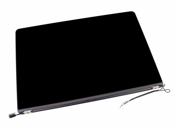

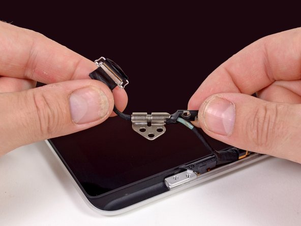

  5. MacBook Pro Retina Display Teardown: step 5, image 1 of 2 MacBook Pro Retina Display Teardown: step 5, image 2 of 2

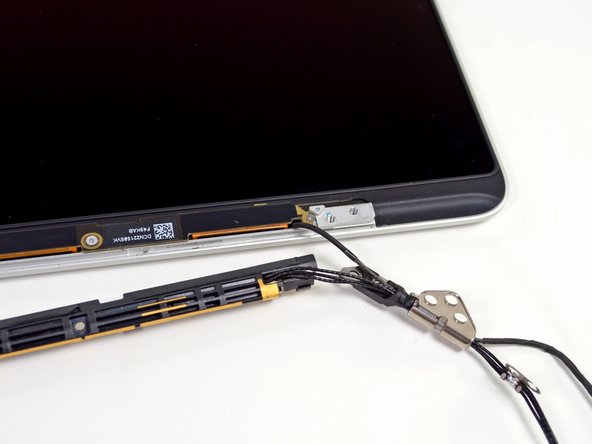

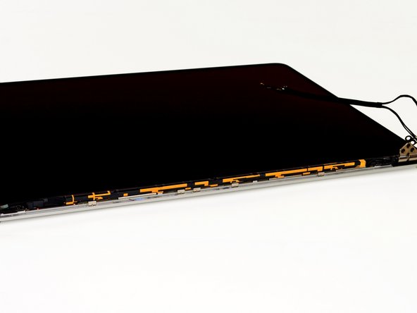

    • In the opposite corner we find another hinge that holds the antenna and FaceTime cables captive.
    • Again, if you need to replace these cables, the hinge has got to go, as well. That might not be so bad, but having to replace all of those cables just because a hinge breaks would be less than ideal.
    • Markings on the inverter board read LP154WT1 (SJ) (A1) GD. Given that the board is soldered to the rest of the display, it appears to be a display manufactured by LG Display.

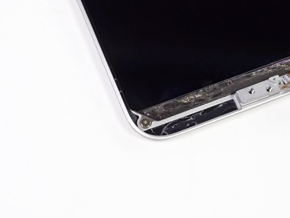

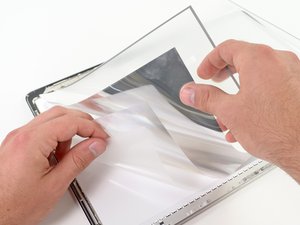

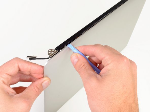

    • Things go back to being a little more familiar as we begin pulling off the rubber display gasket.
    • We were pleasantly surprised to find Phillips screws holding the Retina display in place. If you are trying to repair your Retina display and made it this far, you have earned the right to lay down your pentalobe and Torx bits and dust off your Phillips drivers.
    • The 1 mm gap between the aluminum panel and LCD layers might not seem very large, but to dust and debris it's a gaping hole.

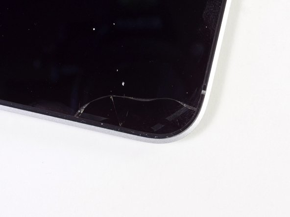

  7. MacBook Pro Retina Display Teardown: step 7, image 1 of 3 MacBook Pro Retina Display Teardown: step 7, image 2 of 3 MacBook Pro Retina Display Teardown: step 7, image 3 of 3

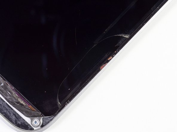

    • Q: What happens when you hand over a groundbreaking notebook display to a group of careful, highly trained technicians?
    • A: They break it.
    • We were as careful as we could possibly be, but the glass on the Retina display is just too fragile.
    • So, how badly did we break it? Well, upon closer inspection we noticed two very distinct lines running around the perimeter of the display, the inner of which was filled with tiny bubbles.
    • Could those be the LCs of our LCD?

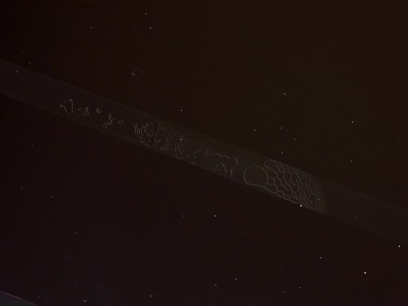

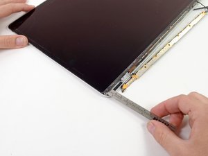

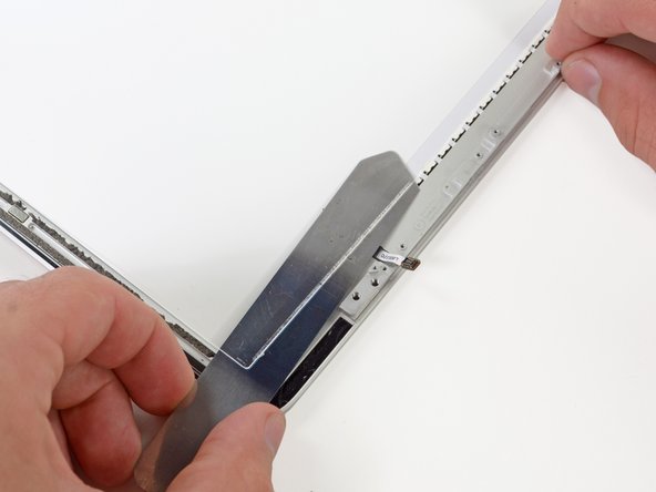

    • Once we got over the fact that obliterating the front panel of the display was the only way to get it out, we grabbed the skinniest tool we could find—an iFixit 6" ruler—and started prying.
    • With the top and sides of the display panel freed, we were able to slide the shattered remains out of the display assembly.
    • There were two thin strips of adhesive underneath the glass holding it in place, with a pattern that closely matched our trail of bubbles.
    • So, what's the lesson here? If you want a world-class laptop screen that doesn't take up much real estate, don't expect to be able to pop it out and back in at will.

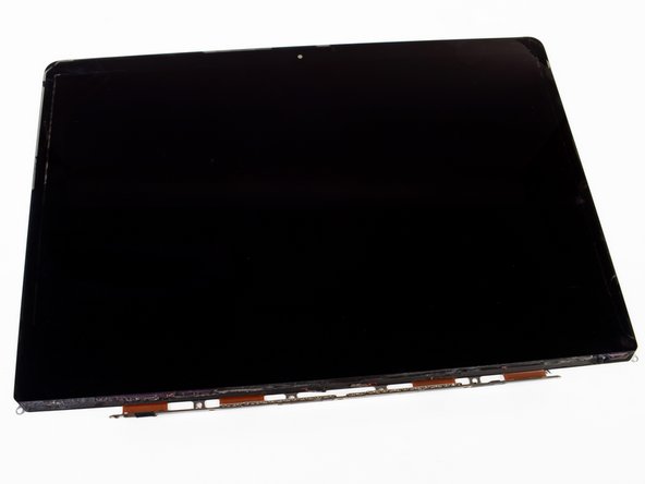

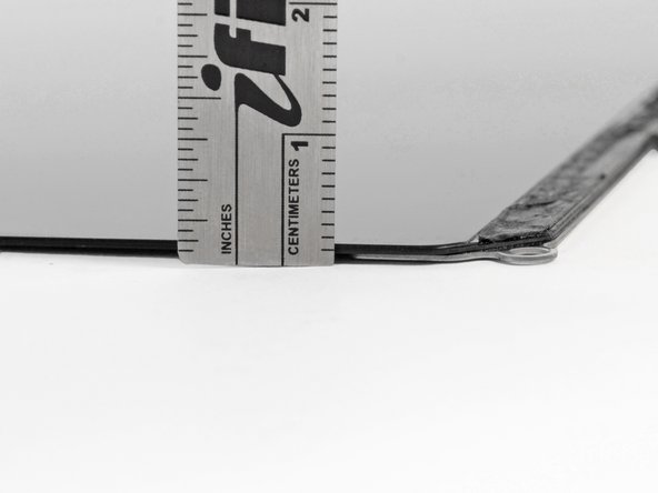

  9. MacBook Pro Retina Display Teardown: step 9, image 1 of 2 MacBook Pro Retina Display Teardown: step 9, image 2 of 2
    • Unfortunately, the Retina display is not nearly as impressive when it's been beaten and broken, but it is still impressively thin.
    • The glued layers are about 1.5 mm thick, and that includes the metal mounting plates.
    • We need to clarify this before continuing with the teardown; Apple did not design and build a 1.5 mm thin LCD panel. They did, however, do something exceptional with the design of this display: rather than sandwich an LCD panel between a back case and a front glass, they used the aluminum case itself as the frame for the LCD panel and used the LCD as the front glass.
    • TL;DR: The entire display assembly is an LCD panel.

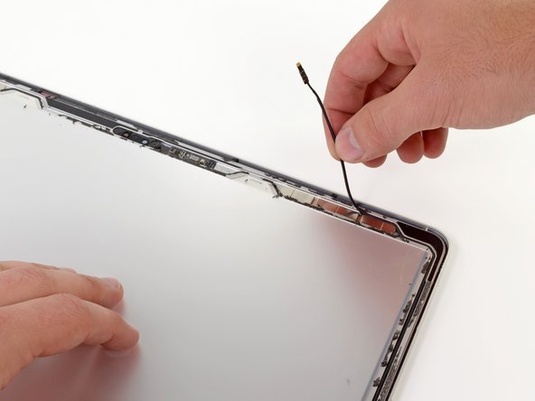

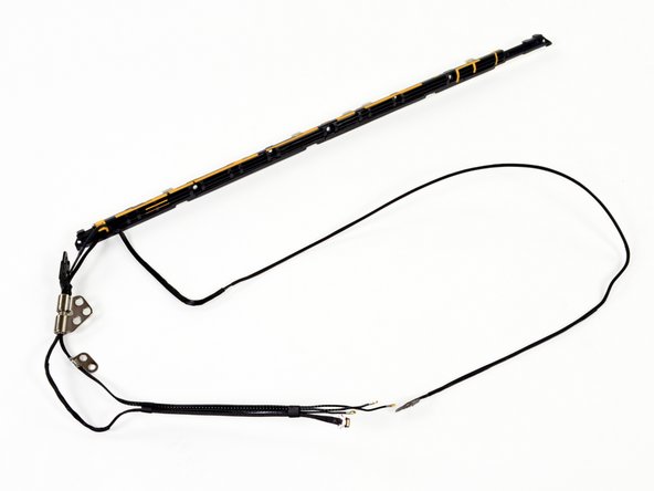

    • At last! With the LCD removed, we can remove the antenna and FaceTime cables from the display assembly.
    • The camera cable is routed along the outside edge of the display assembly, making replacement very difficult and costly. Thankfully the cameras fail very infrequently, if at all.
    • If the FaceTime camera were placed at the bottom of the display, it would likely be much easier to replace, but we wonder what kind of awkward side effects that would cause.

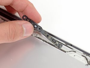

    • iSight, uSight, we all sigh at lame jokes. Anyway, iSight is a thing of the past. This MacBook Pro has a FaceTime camera, allowing you to video chat with your grandmother in full HD.
    • The camera board comes out easily enough, considering the work it took to get there.
    • The camera interfaces with the rest of the computer via the Vimicro VC0358 USB camera interface IC.

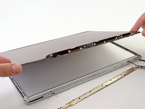

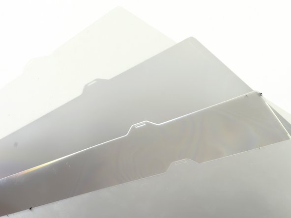

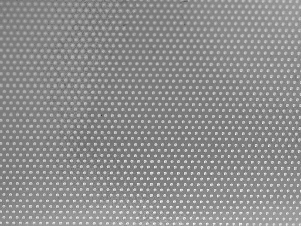

    • The light guide plate is held down by a small strip of mild adhesive—nothing like we saw before.
    • Erring on the side of caution, we proceded very slowly with our modified iSesamo opening tool and removed the plate.
    • Backlight bounces through the plate due to total internal reflection until it hits one of those tiny dots, which sends the light up and out of the front of the plate.
    • By the way, the third picture is an image of the grid found in the clear plastic plate being removed in the second picture. We had to coerce it a bit in Photoshop in order to make it show its grid.

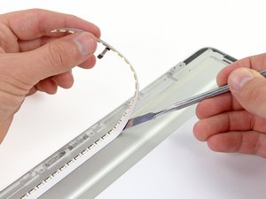

    • The plain-looking sheet of white paper serves as a uniform white background for the LCD's backlight.
    • What else would you use to light an LED-backlit display? LEDs, of course!

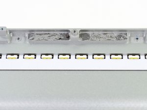

    • A strip of 48 LEDs at the bottom of the display assembly provides all the light your Retina display needs.

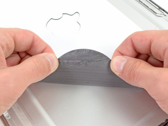

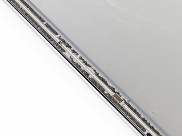

    • There's no real reason to pull the foam off the inside of the back case, but this is a teardown, so we're doing it.
    • We suspect that the foam is there to provide a flat, even surface for the LCD glass to brace against. But there is one thing that we do know about it: it is super sticky.

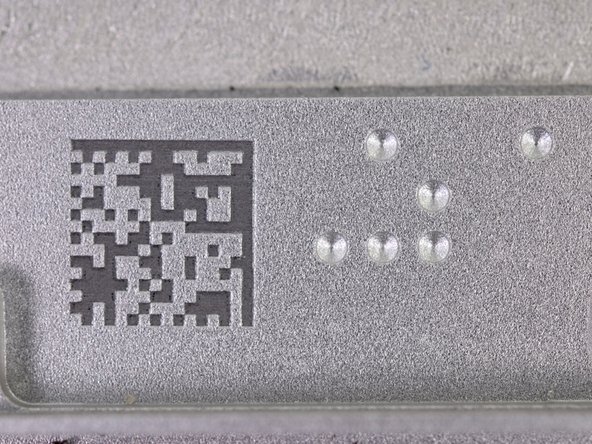

    • The bottom edge of the case has two features that we found pretty neat: a laser engraved data matrix code and a nifty arrangement of round indentations.
    • Upon further inspection and with the help of some keen-eyed readers, it appears that those dots form the pattern of a glider from Conway's Game of Life, the universal symbol for hackers.
    • That sixth dot to the right, though? Apparently, if you were to place that dot while playing, it would lead the glider into a state of death. Is Apple trying to send us a message?

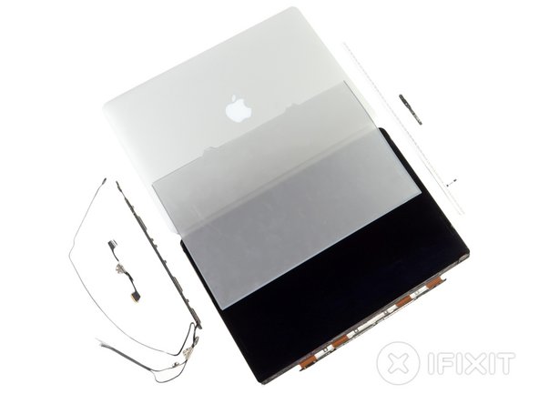

    • And there you have it, the Retina display from the new MacBook Pro.
    • Normally we would provide you with a repairability score at this point, but since this display is part of another device, that's not really appropriate.
    • What we can tell you is that if anything in the display assembly breaks, you'll need to replace the whole thing. It will be more expensive than just replacing the LCD inside a regular MacBook Pro, but it will also make the choice (of whether to replace just LCD or entire display assembly) very easy.

So how does the logo get lit when the laptop is on, if it is sitting behing that foam sheet.....?
Spiros - Reply
Look at step 15, and you'll see that the foam is cut out for the logo.
