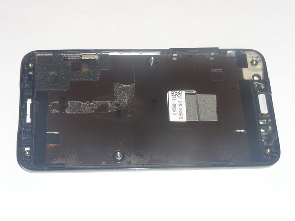

The basic dis-assembly steps went smoothly. I had all the tools and skills for the task. The preliminary steps took only 15 minutes.

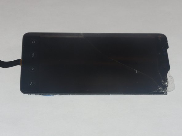

The last step of the dis-assembly was heating the glass to loosen the adhesive and gently prying it away from the bezel and the screen. Despite my patience and over 1 hour of heating and gently prying, the screen stayed adhered to the glass and eventually cracked as I was prying it out of the case.
My Advice
My best guess is that I simply didn't heat up the adhesive hot enough or long enough. My main concern was not melting any plastic part that I needed to retain.
Think twice before attempting glass replacement on a phone for the first time. Is there an experienced person who can guide you through the process? Have you ever pulled the glass off a similar item, like a tablet?
I have been taking things apart for over 4 decades. Admittedly I've been fixing and re-assembling them for less than that, maybe 3 decades or so.
This was my first attempt at a smartphone or a touch-screen for that matter...but its not likely to be my last. I'd like to watch a detailed (i.e. boring) video of someone removing the glass on a smartphone before I try it again.
