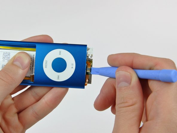

      • Insert the edge of an iPod opening tool into the gap between the outer case and the top bezel.
      • Pry the top bezel off the adhesive securing it to the display retainer.
      • At this point the hold switch slider is free and may fall. Be careful not to lose it.

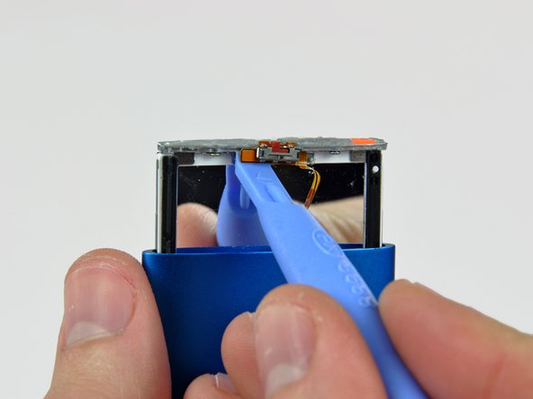

    2. iPod Nano 4th Generation Battery Replacement: step 2, image 1 of 1
      • Remove the hold switch slider from the top of the Nano.

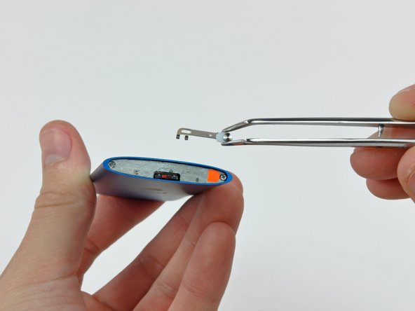

    3. iPod Nano 4th Generation Battery Replacement: step 3, image 1 of 1
      • Remove the two angled Phillips screws from the two corners of the display retainer.
      • These screw heads are extremely small and easily stripped.
      Ask FixBot

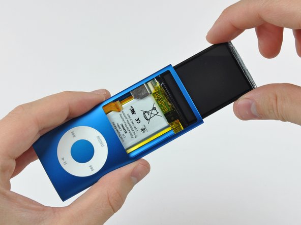

    4. iPod Nano 4th Generation Battery Replacement: step 4, image 1 of 1
      • Insert an iPod opening tool between the outer case and the display retainer.
      • Use the tool to slide the display assembly out of the case slightly.
      • Do not rotate the display retainer about the top edge of the display, as it is attached to a thin steel bracket that is easily broken.
      • Do not forcefully remove the display retainer, as the hold switch cable is liable to snap.

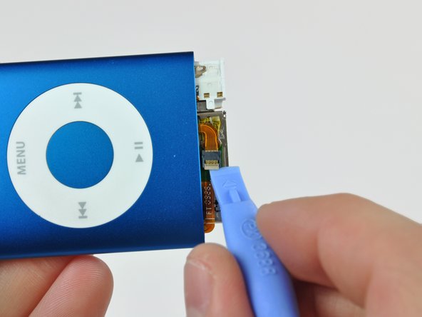

    2. iPod Nano 4th Generation Battery Replacement: step 9, image 1 of 1
      • Peel back the Kapton tape covering the display data cable socket.
      Ask FixBot

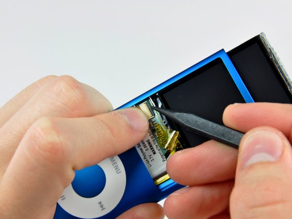

    3. iPod Nano 4th Generation Battery Replacement: step 10, image 1 of 1
      • While holding the light colored socket down with one finger, use the tip of a spudger to flip the ZIF cable lock up toward the bottom of the Nano.
      Ask FixBot

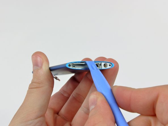

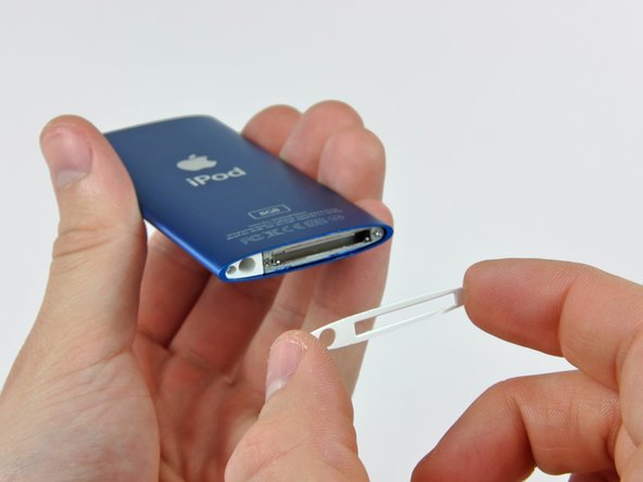

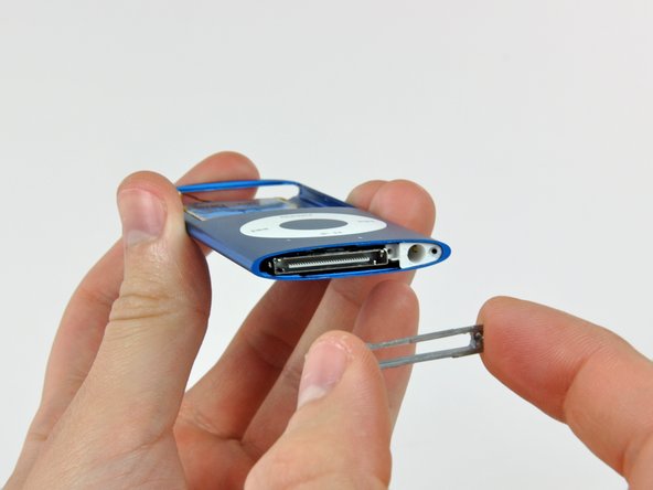

    1. iPod Nano 4th Generation Battery Replacement, Logic Board Assembly: step 13, image 1 of 2 iPod Nano 4th Generation Battery Replacement, Logic Board Assembly: step 13, image 2 of 2
      • Insert an iPod opening tool between the bottom bezel and the dock connector.
      • Separate the bottom bezel from the adhesive securing it to the Nano and set it aside.
      Ask FixBot

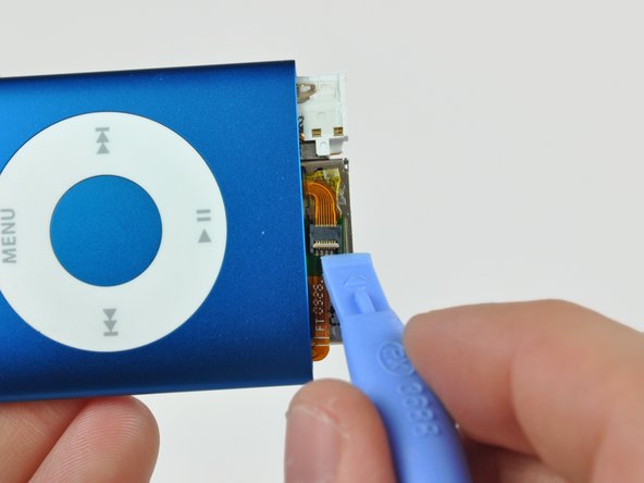

    5. iPod Nano 4th Generation Battery Replacement: step 17, image 1 of 1
      • Use the edge of an iPod opening tool to peel the click wheel ribbon cable and its ZIF socket off the dock connector.
      Ask FixBot
    6. iPod Nano 4th Generation Battery Replacement: step 18, image 1 of 2 iPod Nano 4th Generation Battery Replacement: step 18, image 2 of 2
      • Use the edge of an iPod opening tool to flip the ZIF cable lock up toward the headphone jack.
      Ask FixBot

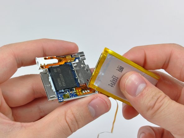

    1. iPod Nano 4th Generation Battery Replacement, Battery: step 21, image 1 of 2 iPod Nano 4th Generation Battery Replacement, Battery: step 21, image 2 of 2
      • Peel the hold switch cable from along the edge of the battery and lay it aside. The hold switch cable is not attached to the battery.
      • The battery is held on to the logic board by a strong adhesive. Force may be required to remove the battery from the logic board.
      • Pry the battery off the adhesive securing it to the metal tray on the logic board.
      Ask FixBot

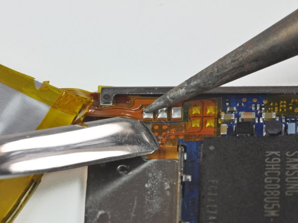

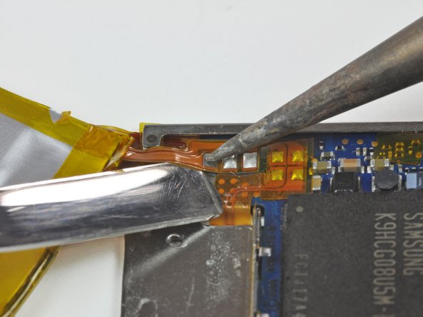

    2. iPod Nano 4th Generation Battery Replacement: step 22, image 1 of 2 iPod Nano 4th Generation Battery Replacement: step 22, image 2 of 2
      Tool used on this step:
      FixHub Smart Soldering Iron
      $79.95
      Buy
      • The battery on the fourth generation nano is attached via solder pads with small holes that go through the battery ribbon cable and attach to flat pads on the face of the logic board. In this step, you will heat each solder pad individually while using a metal spudger to pry it up from the logic board.
      • DO NOT bridge the connection between the solder pads both on the board and on the ribbon cable with your spudger. Shorts have the potential to ruin the logic board.
      • Beware of overheating the board and the cable. Only hold the tip of the iron against the pad long enough to let the solder melt. Excess heat buildup has the potential to ruin the logic board or melt the ribbon cable. Consider letting the board cool off between melting each solder pad.
      • Start working from one side of the battery ribbon cable. In our case, we started on the left. Heat the leftmost solder pad while gently prying up from under the ribbon cable to free it from the board.
      Ask FixBot

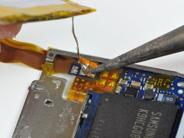

    3. iPod Nano 4th Generation Battery Replacement: step 23, image 1 of 2 iPod Nano 4th Generation Battery Replacement: step 23, image 2 of 2
      • Repeat the previous step for each of the two remaining pads, working either right to left or left to right.
      • At this point, the battery should be free from the logic board.
      • Lift the old battery out of the nano and set it aside.
