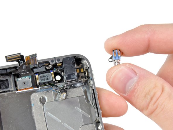

    1. iPhone 4 Power & Sensor Cable Replacement, Power & Sensor Cable: step 22, image 1 of 2 iPhone 4 Power & Sensor Cable Replacement, Power & Sensor Cable: step 22, image 2 of 2
      • Remove the following two screws securing the vibrator to the inner frame:
      • One 6 mm Phillips
      • One 1.4 mm Phillips
      • Remove the vibrator from the inner case.
