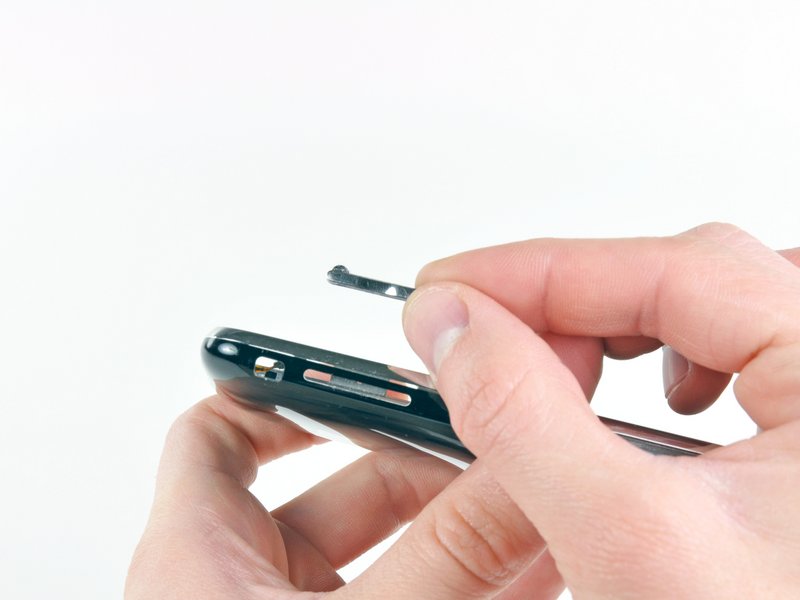

    1. iPhone 3G Volume Button Replacement, Volume Button: step 23, image 1 of 2 iPhone 3G Volume Button Replacement, Volume Button: step 23, image 2 of 2
      • If they have not already fallen out of the rear case, remove the mute button and the power button.
      Ask FixBot

    5. iPhone 3G Volume Button Replacement: step 27, image 1 of 2 iPhone 3G Volume Button Replacement: step 27, image 2 of 2
      • Once you have lifted the silver bezel enough to clear the volume button, use the edge of your opening tool to push the volume button toward the inside of the rear panel.
      • Remove the volume button.
