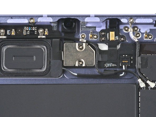

    1. iPad Mini 6 Front Camera Replacement, Unfasten the front camera shield: step 15, image 1 of 2 iPad Mini 6 Front Camera Replacement, Unfasten the front camera shield: step 15, image 2 of 2
      • Use a Phillips #000 screwdriver to remove the two 1.2 mm screws securing the front camera shield to the frame.
      Ask FixBot
    2. iPad Mini 6 Front Camera Replacement, Disconnect the volume button board: step 16, image 1 of 2 iPad Mini 6 Front Camera Replacement, Disconnect the volume button board: step 16, image 2 of 2
      • Use the tip of a spudger to pry up and disconnect the volume button board's coaxial cable.
      • During reassembly, these can be tricky to reconnect. Hold each connector in place over its socket and press down with the flat end of a spudger. The connector should snap into place.
      Ask FixBot
    3. iPad Mini 6 Front Camera Replacement, Unfasten the volume button board's coaxial cable: step 17, image 1 of 2 iPad Mini 6 Front Camera Replacement, Unfasten the volume button board's coaxial cable: step 17, image 2 of 2
      • Use a Phillips #000 screwdriver to remove the 1 mm screw securing the volume button board's coaxial cable to the frame.
      Ask FixBot
    4. iPad Mini 6 Front Camera Replacement, Reposition the coaxial cable: step 18, image 1 of 2 iPad Mini 6 Front Camera Replacement, Reposition the coaxial cable: step 18, image 2 of 2
      Tool used on this step:
      Buy
      • Use tweezers, or your fingers, to pull the coaxial cable away from the frame, making sure to separate the tape keeping it in place.
      Ask FixBot
    5. iPad Mini 6 Front Camera Replacement, Disconnect the volume button board: step 19, image 1 of 2 iPad Mini 6 Front Camera Replacement, Disconnect the volume button board: step 19, image 2 of 2
      • Use a spudger to pry up and disconnect the volume button board's press connector secured to the frame.
      Ask FixBot
    6. iPad Mini 6 Front Camera Replacement, Disconnect the front camera: step 20, image 1 of 2 iPad Mini 6 Front Camera Replacement, Disconnect the front camera: step 20, image 2 of 2
      • Use a spudger to pry up and disconnect the front camera board's press connector secured to the frame.
      Ask FixBot
    7. iPad Mini 6 Front Camera Replacement, Separate the front camera's adhesive: step 21, image 1 of 2 iPad Mini 6 Front Camera Replacement, Separate the front camera's adhesive: step 21, image 2 of 2
      • The front camera is secured to the frame with light adhesive.
      • Insert the flat end of a spudger between the front camera and the frame.
      • Gently pry up while pushing the spudger deeper into the gap to separate the adhesive.
      Ask FixBot
    8. iPad Mini 6 Front Camera Replacement, Remove the front camera: step 22, image 1 of 2 iPad Mini 6 Front Camera Replacement, Remove the front camera: step 22, image 2 of 2
      • Use tweezers, or your fingers to remove the front camera.
      Ask FixBot
