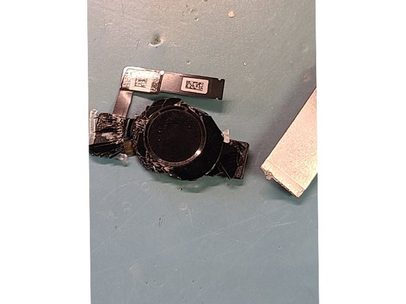

      • Cracked near home button its important to not break home button flex cable
      • Apply heat to the screen! Do NOT SKIP THIS STEP
      • Make sure to turn it off if you can to prevent breaking the backlight filter

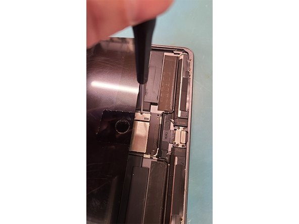

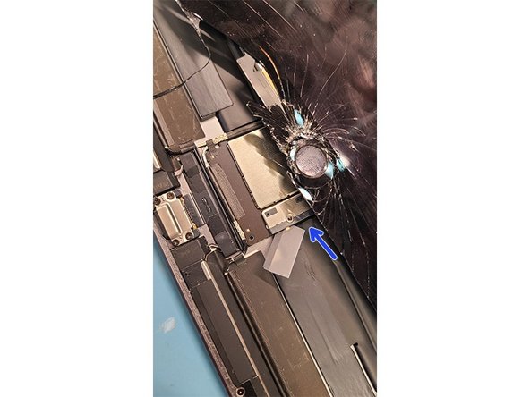

      • Set screen up a little bit to get to power connection

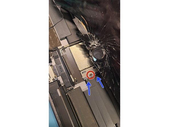

      • Power connection has PH000 screw holding it together
      • Slide a card under connection
      • Its very important to disconnect battery try turning it on make sure it is off to avoid further damage to ipad

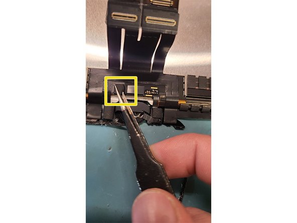

      • Lift display back up to get to the display cables
      • Unscrew 2 PH000 Screws from display cable bracket
      • Use the flat end of plastic spudger to lift off connections
      • There is 4 flex cables that need disconnecting

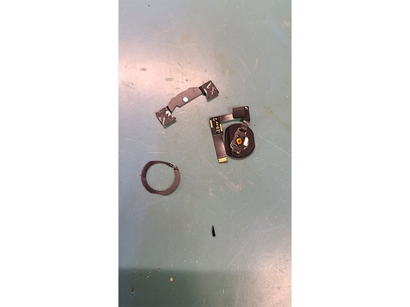

      • APPLY HEAT TO HOME BUTTON 15-20 Seconds should do the trick
      • If heat is not applied you might break the home button along with the touch ID. If you replace the home button touch ID will not work anymore
      • Take of home button flex cover
      • Use flat end of spudger to pry up home button flex connector
