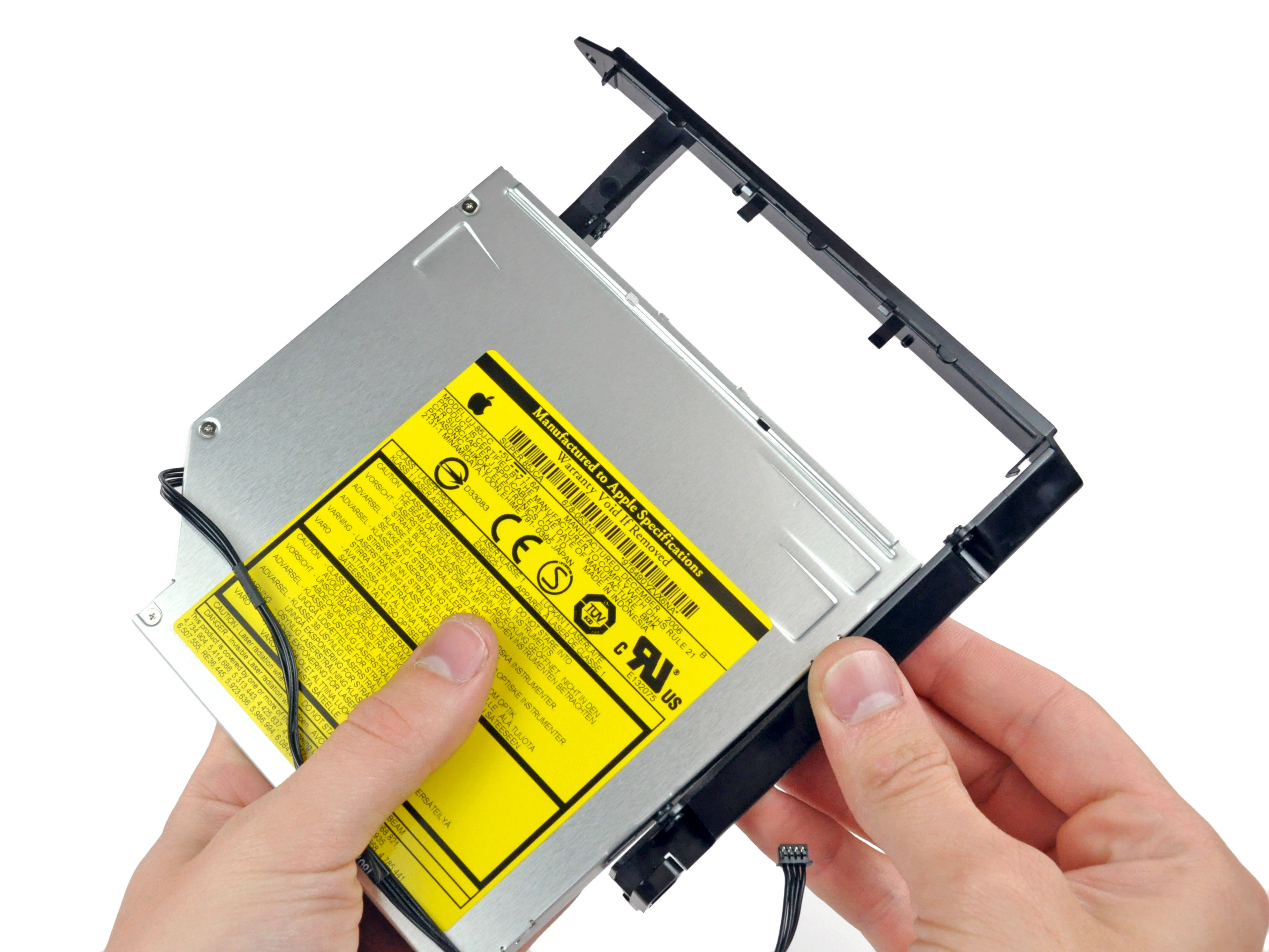

Introduction
Replace a broken optical drive to read compact disks.

Pull the optical drive bracket toward the open end of the optical drive to free it from the optical drive.
  • Pull the optical drive bracket toward the open end of the optical drive to free it from the optical drive.
