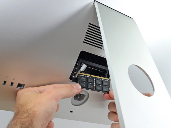

      • While holding the display steady, use the flat end of a spudger to press in on the RAM door release button, located just above the power port.
      • You may have to press fairly hard—keep at it until the bottom of the door pops out about 0.25" from the rear of the iMac.

    2. iMac Intel 27" EMC 2546 RAM Replacement, Remove the RAM door: step 2, image 1 of 3 iMac Intel 27" EMC 2546 RAM Replacement, Remove the RAM door: step 2, image 2 of 3 iMac Intel 27" EMC 2546 RAM Replacement, Remove the RAM door: step 2, image 3 of 3
      • Pull the RAM access door off the back of the iMac.

    3. iMac Intel 27" EMC 2546 RAM Replacement, Unlock the RAM tray: step 3, image 1 of 3 iMac Intel 27" EMC 2546 RAM Replacement, Unlock the RAM tray: step 3, image 2 of 3 iMac Intel 27" EMC 2546 RAM Replacement, Unlock the RAM tray: step 3, image 3 of 3
      • The RAM tray is locked into its upright position with two grey tabs.
      • Use your thumbs or index fingers to unlock the tray by pushing the tabs outward, away from the RAM.
      • Pull the tabs out and down, swinging the RAM tray down to a near-horizontal position.

    4. iMac Intel 27" EMC 2546 RAM Replacement, Remove the RAM: step 4, image 1 of 3 iMac Intel 27" EMC 2546 RAM Replacement, Remove the RAM: step 4, image 2 of 3 iMac Intel 27" EMC 2546 RAM Replacement, Remove the RAM: step 4, image 3 of 3
      • Remove a stick of RAM by grabbing it with two hands and pulling straight out of the RAM tray.
      • RAM modules are keyed so that they can only be installed in the proper orientation. Note where the shorter section of contacts is when removing, and reinstalling, your RAM.
      • To install a new module, insert the module into the desired slot in the tray and press it firmly in place. Push the tray back up until it locks in place.
      • The RAM access door is not symmetrical. If it is not flush on both ends, try putting it in the other way.
      • Re-insert the RAM access door back into its place.
