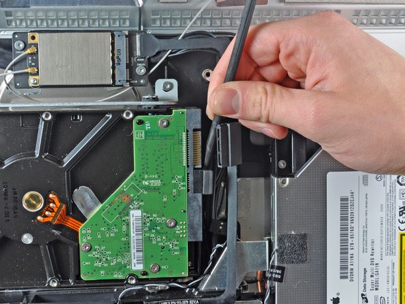

Disconnect the thermal sensor by pulling its connector away from the side of the hard drive.
Disconnect the SATA data cable by pulling its connector away from the hard drive.
Use the flat end of a spudger to help disconnect the SATA power connector from the hard drive.

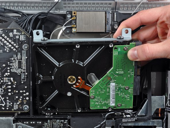

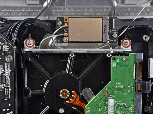

Remove the two 9 mm T10 Torx screws securing the upper hard drive bracket to the outer case.
Slightly rotate the hard drive out of the outer case and lift it up off its mounting pins toward the top edge of the iMac.

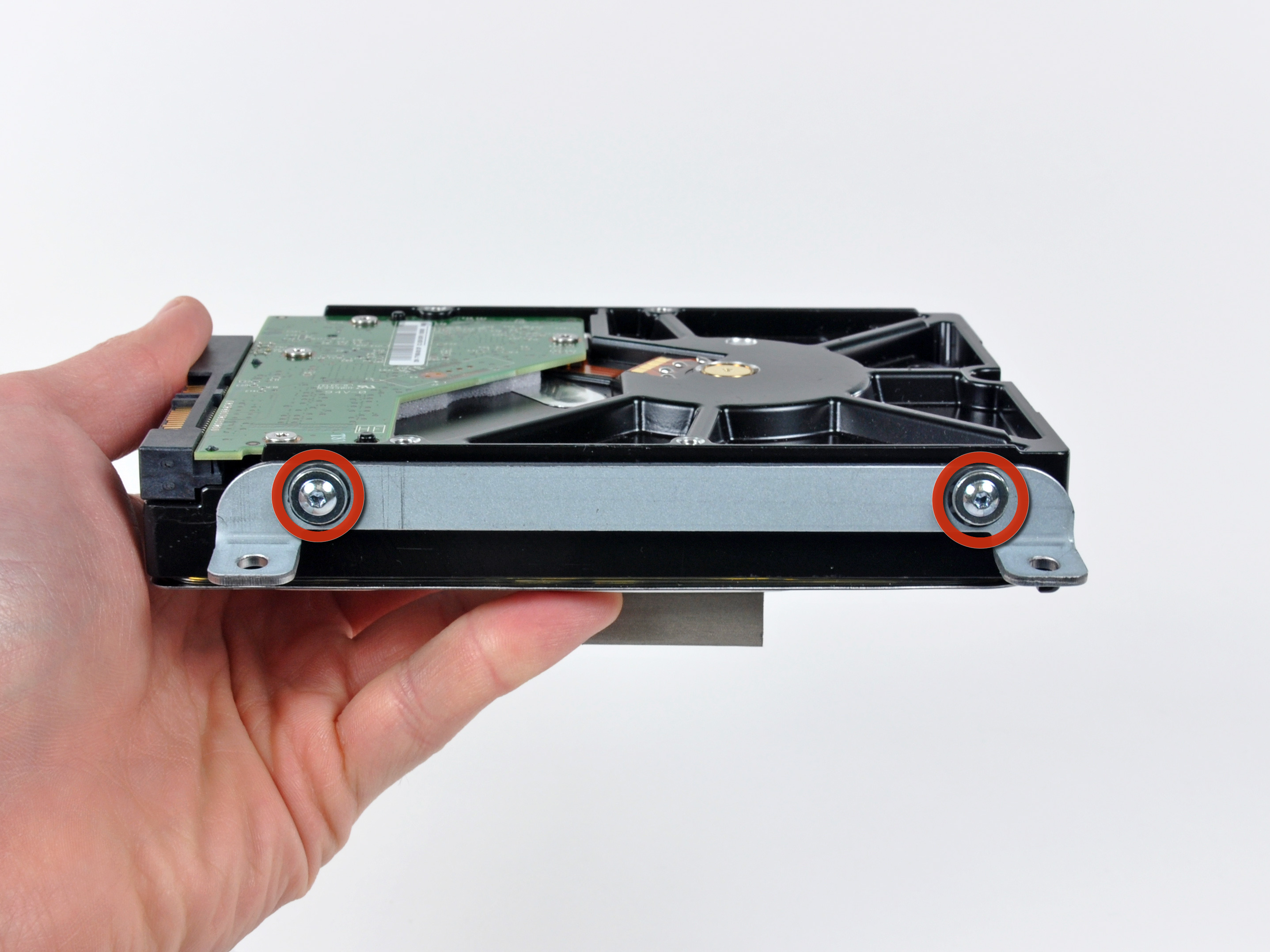

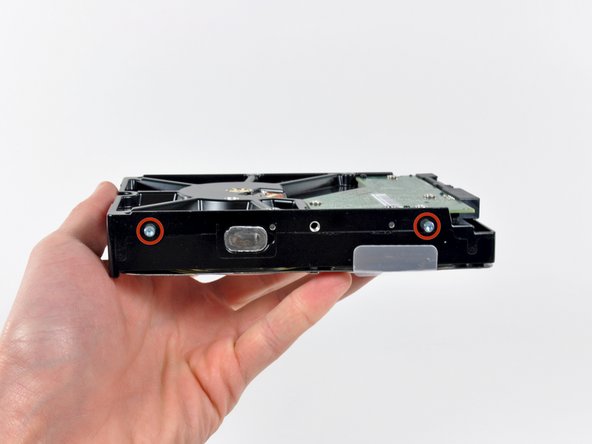

Remove the two T8 Torx screws securing the upper bracket to the hard drive.
Remove the upper bracket from the hard drive.
