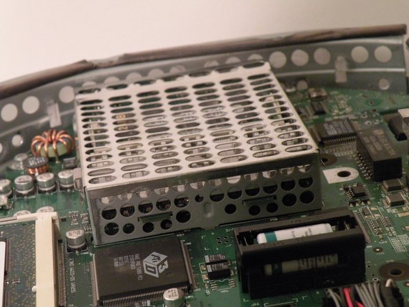

    2. iMac G3 Model M4984 RAM Replacement: step 10, image 1 of 3 iMac G3 Model M4984 RAM Replacement: step 10, image 2 of 3 iMac G3 Model M4984 RAM Replacement: step 10, image 3 of 3

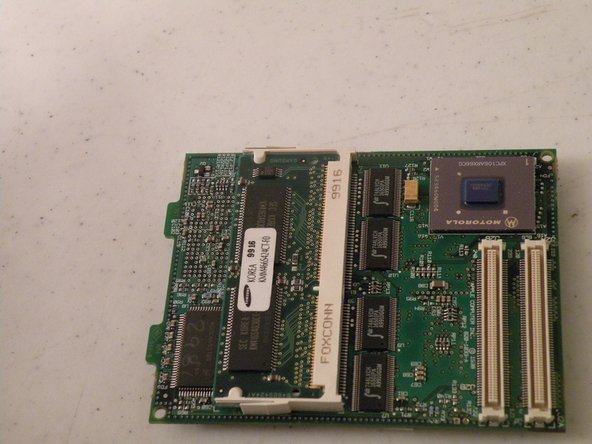

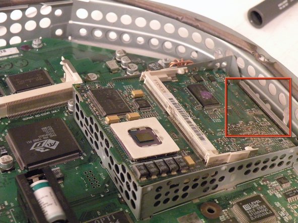

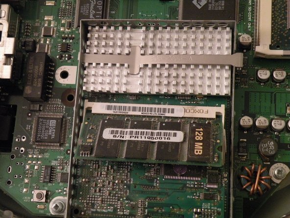

      • Remove the CPU shield, this will reveal the "top slot". This is the user-serviceable RAM slot, though there is a a second slot of RAM under the CPU card.
      • The iMac uses PC100 Laptop Ram, and according to Apple, it supports up to 256MB RAM (2X128MB) but unofficially. Some later models can support 512MB (2X256MB).
      • Push the tabs out, and the RAM should pop up, then pull the ram out.

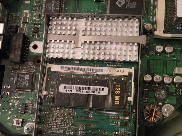

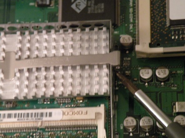

    3. iMac G3 Model M4984 RAM Replacement: step 11, image 1 of 2 iMac G3 Model M4984 RAM Replacement: step 11, image 2 of 2
      • RAM (bottom slot).

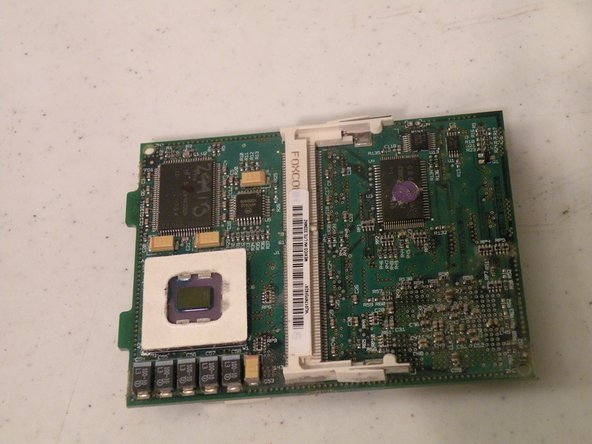

      • Remove the CPU Heatsink.
      • Use a flathead screwdriver. Remove the heatsink clip, it will pop off, and may get lost if you don't keep track of it.
      • Remove the heatsink revealing the CPU, then lift the CPU card up, and it should come free with a little tug.
      Ask FixBot

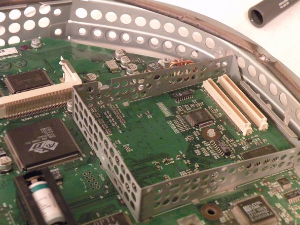

    4. iMac G3 Model M4984 RAM Replacement: step 12, image 1 of 3 iMac G3 Model M4984 RAM Replacement: step 12, image 2 of 3 iMac G3 Model M4984 RAM Replacement: step 12, image 3 of 3
      • Removing the CPU Card:
      • Lift the card out by this end!
      Ask FixBot

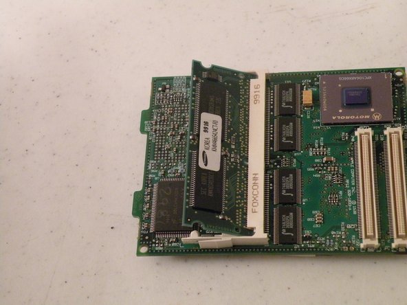

      • Now, flip the card over.
      • This will reveal another stick of laptop PC66.
      • This is most likely a 32MB Stick, because the iMac shipped standard with only 32MB of RAM.
      • Now, remove it by pushing the tabs, it should pop up, and you can set it aside.

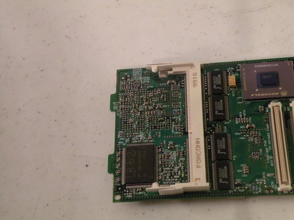

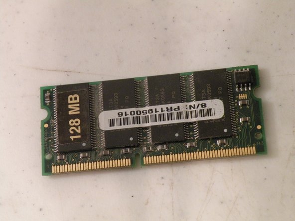

    6. iMac G3 Model M4984 RAM Replacement: step 14, image 1 of 1
      • The RAM.
      • The iMac supports two pieces of PC66 laptop RAM, though it can use PC100 and PC133 (laptop size of course).
