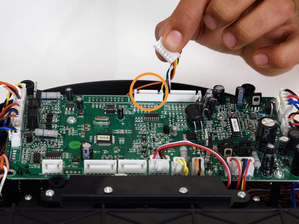

    4. bObsweep Robotic Vacuum Main Board  Replacement: step 4, image 1 of 2 bObsweep Robotic Vacuum Main Board  Replacement: step 4, image 2 of 2
      • Remove three circuit plugs from the motherboard. Pinch the small white tab on the side of each circuit plug and pull straight up to release each from the motherboard.
      • 1. On the bottom left corner: a small connector with red, black and white wires.
      • 2. One thick white wire that attaches on the right side of the previous connector.
      • 3. On the top edge of bOb’s motherboard: a wide multicoloured connector.
      • Place the cover aside and begin your repair.

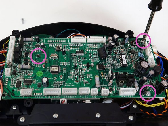

    1. bObsweep Robotic Vacuum Main Board  Replacement, Main Board: step 5, image 1 of 2 bObsweep Robotic Vacuum Main Board  Replacement, Main Board: step 5, image 2 of 2
      • After opening bObsweep, you will see the main board in the center. To remove it, you will need to unplug 11 more circuit plugs and uninstall 3 screws.
      • There is one in the centre of the motherboard, near the multicoloured plug for Bob’s left wheel.
      • The second is close to the top right corner.
      • The third is near the bottom right edge.
      • Keep all three screws. They will be needed later while installing the replacement main board.
      Ask FixBot

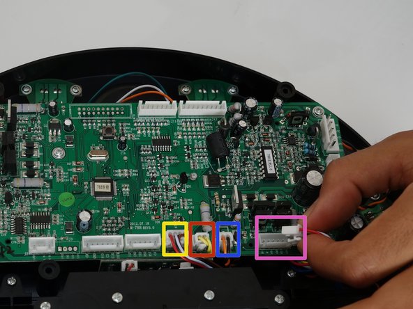

    2. bObsweep Robotic Vacuum Main Board  Replacement: step 6, image 1 of 3 bObsweep Robotic Vacuum Main Board  Replacement: step 6, image 2 of 3 bObsweep Robotic Vacuum Main Board  Replacement: step 6, image 3 of 3
      • Detach all of the motherboard's circuit plugs. Keep note of where each plug attaches for installation of the new one.
      • Lift the main board up and replace it with a new functional one. Make sure the replacement main board lies flat on top of the screw posts inside bObsweep.
      • Re-install the 3 screws you removed in the previous step.
      • All the circuit plugs you removed in the first step must be reconnected in the correct spaces.
      Ask FixBot

    4. bObsweep Robotic Vacuum Main Board  Replacement: step 8, image 1 of 2 bObsweep Robotic Vacuum Main Board  Replacement: step 8, image 2 of 2
      • The order from left to right along the bottom ledge should be reconnected as follows:
      • A circuit plug with multicolored wires and a wide base which connects to Bob's right wheel.
      • A small black and orange wired circuit plug
      • A small yellow wired plug.
      • A small circuit plug with red, black, white, and brown wires.
      • There will be 3 empty spaces left on this row. Two will be filled when you put the cover back on.

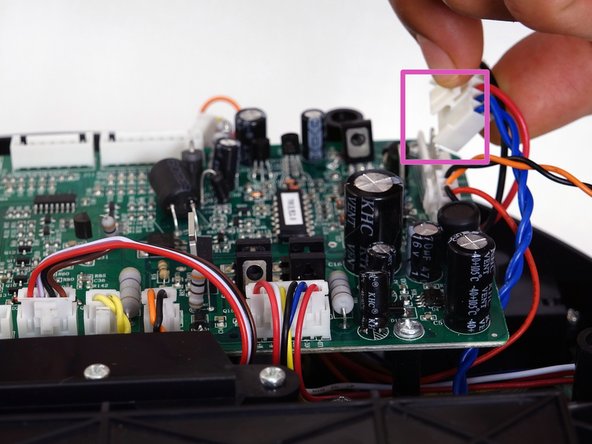

    5. bObsweep Robotic Vacuum Main Board  Replacement: step 9, image 1 of 3 bObsweep Robotic Vacuum Main Board  Replacement: step 9, image 2 of 3 bObsweep Robotic Vacuum Main Board  Replacement: step 9, image 3 of 3
      • At the top of the motherboard’s right edge is a wide, red, black, and blue circuit plug.
      • Beneath that is a smaller plug for Bob’s power inlet with orange and black wires.
      • Plug each one into the motherboard in the suitable slot.
      Ask FixBot

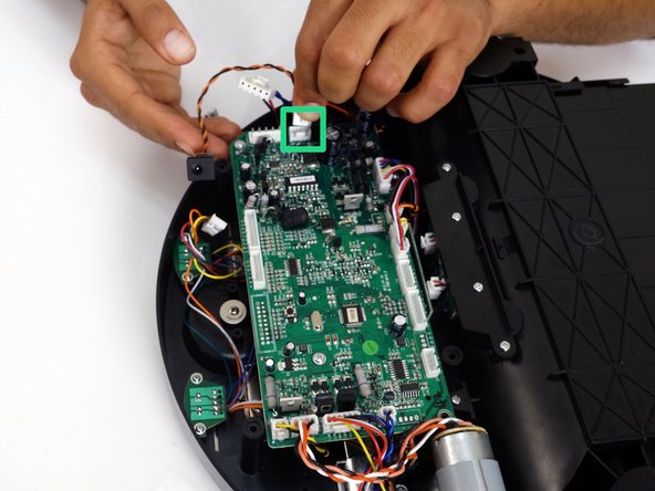

    6. bObsweep Robotic Vacuum Main Board  Replacement: step 10, image 1 of 2 bObsweep Robotic Vacuum Main Board  Replacement: step 10, image 2 of 2
      • There are two wide, multicoloured circuit plugs that attach to the top edge of the motherboard. One was removed to detach bObsweep’s cover, so the space will stay empty for now.
      • The other plugs in on the right side of the open space.
      Ask FixBot
