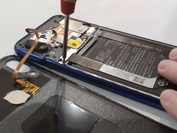

  8. Xiaomi Redmi Note 7 Screen and Metal case Replacement, Removing cable protecting plates: step 8, image 1 of 3 Xiaomi Redmi Note 7 Screen and Metal case Replacement, Removing cable protecting plates: step 8, image 2 of 3 Xiaomi Redmi Note 7 Screen and Metal case Replacement, Removing cable protecting plates: step 8, image 3 of 3
    Tool used on this step:
    Buy
    • Locate the screws of the protective metal plate placed on the connector on the left and on the two connectors on the right
    • As shown use a philips screwdriver to remove the highlited screws
    • Then remove the metal plates with a pair of tweezers or with your finger.
  9. Xiaomi Redmi Note 7 Screen and Metal case Replacement, Unplugging the ribbon cables: step 9, image 1 of 2 Xiaomi Redmi Note 7 Screen and Metal case Replacement, Unplugging the ribbon cables: step 9, image 2 of 2
    • With a prying tool gently pull up the cable connector to disconnect it from the board
    • Now do the same for the battery and power cables on the right

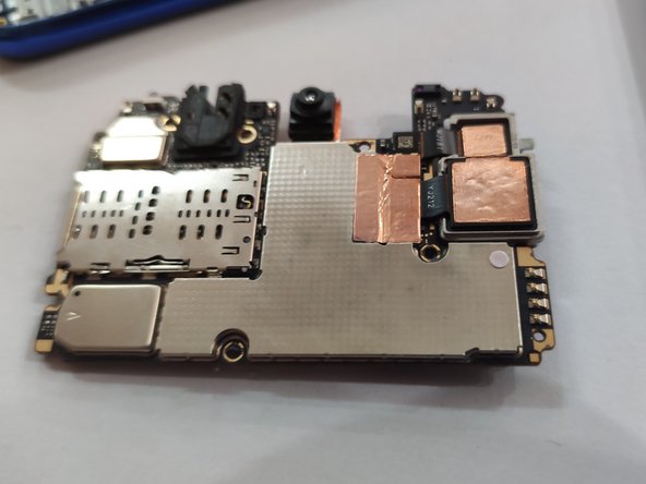

  11. Xiaomi Redmi Note 7 Screen and Metal case Replacement, Remove Electronics: step 11, image 1 of 3 Xiaomi Redmi Note 7 Screen and Metal case Replacement, Remove Electronics: step 11, image 2 of 3 Xiaomi Redmi Note 7 Screen and Metal case Replacement, Remove Electronics: step 11, image 3 of 3
    • First unplug the antenna with a pair of tweezers as shown in the first picture.
    • now you can gently lift off all the electronics from the housing. Beware that it is attached with thermal paste and glue so you might want to apply some jiggling movement to favour the removal.
    • Beware where you place your prying tool! It may damage or inadvertently break an electronic component!
  12. Xiaomi Redmi Note 7 Screen and Metal case Replacement, Clean the thermal paste: step 12, image 1 of 2 Xiaomi Redmi Note 7 Screen and Metal case Replacement, Clean the thermal paste: step 12, image 2 of 2
    • Once the motherboard is removed you want to clean it with isopropil alchool before applying the new thermal compound to the new case
    • You can use an ear stick soaked with alchool to remove the old paste or any greasy residue

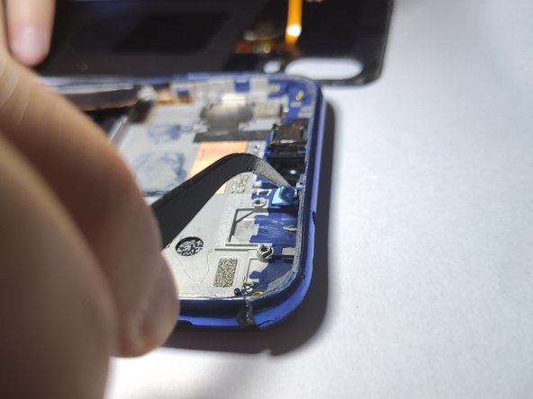

  13. Xiaomi Redmi Note 7 Screen and Metal case Replacement, Remove proximity sensor: step 13, image 1 of 3 Xiaomi Redmi Note 7 Screen and Metal case Replacement, Remove proximity sensor: step 13, image 2 of 3 Xiaomi Redmi Note 7 Screen and Metal case Replacement, Remove proximity sensor: step 13, image 3 of 3
    • You now have to remove the proximity sensor from the case
    • You can lift it with a pair of tweezers or with your bare fingers
    • do the same thing with the blue plastic component highlighted in the picture

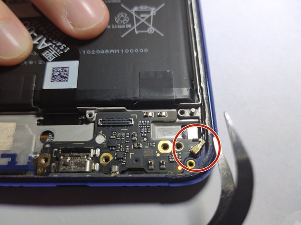

  15. Xiaomi Redmi Note 7 Screen and Metal case Replacement, Remove Bottom Electronics: step 15, image 1 of 2 Xiaomi Redmi Note 7 Screen and Metal case Replacement, Remove Bottom Electronics: step 15, image 2 of 2
    • The bottom module is secured by a single screw
    • please remove the antenna connector as shown in the second picture
    • To remove this module use a prying tool under the edges of the module to gently jiggle it until you can lift it
    • The module is held in place by glue, you need to move it a little until the adhesive loosens and NOT to simply try to lift it
    • Remember not to place your tweezer or prying tool under any electronic component, use parts of the pcb that look flat, please prefer plastic tools to metal ones

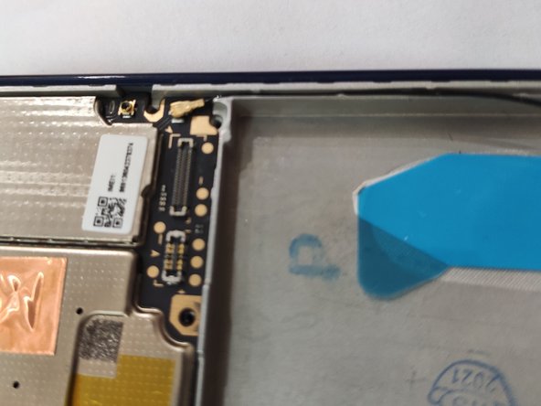

  18. Xiaomi Redmi Note 7 Screen and Metal case Replacement, Secure back the bottom electronics: step 18, image 1 of 3 Xiaomi Redmi Note 7 Screen and Metal case Replacement, Secure back the bottom electronics: step 18, image 2 of 3 Xiaomi Redmi Note 7 Screen and Metal case Replacement, Secure back the bottom electronics: step 18, image 3 of 3
    • Before placing back the board you may want to remove a plastic film that protects new glue for the components
    • Put the board back in place until it sits firmly standing in the groove, the glue should also keep that in place
    • connect back the ribbon cable
    • place the speaker back and secure it with the eight screws as in step seven.
    • As you can see from the picture if there are cables or films that are in the way while you assemble your phone, you can use tape to help you out

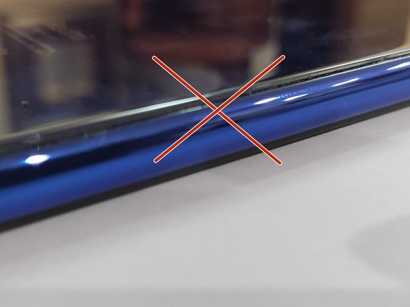

    • To close your phone you could use the original adhesive if you were careful enough during removal, though this could lead to later unsealing of the case; hence I suggest you to use a specific glue like the B-7000 glass glue
    • Put either the adhesive or the glue around the perimeter of the phone (not the rear glass) in the most homogeneous way possible
    • After application gently close the rear glass and apply some pressure
    • You should apply even pressure on the whole screen for many hours, you should use the screen clamps to guarantee perfect adhesion
    • If your phone looks like the last picture simply heat it up again and remove all the adhesive with isopropil alchool and start again. otherwile it could open at any moment
    • Don't worry if some glue pops out from the borders, you'll be able to remove it once dried either with your fingernails or isopropil alchool
