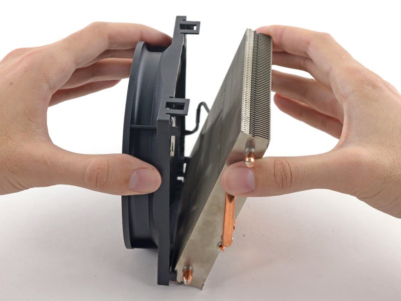

    1. Xbox One Heat Sink Replacement, Heat Sink: step 36, image 1 of 3 Xbox One Heat Sink Replacement, Heat Sink: step 36, image 2 of 3 Xbox One Heat Sink Replacement, Heat Sink: step 36, image 3 of 3
      • The fan is held onto the heat sink with four sturdy plastic clips.
      • Use a plastic opening tool to pry the two clips on one side out of the channel in the side of the heat sink.
      Ask FixBot
    2. Xbox One Heat Sink Replacement: step 37, image 1 of 2 Xbox One Heat Sink Replacement: step 37, image 2 of 2
      • Separate the heat sink from the fan.
      Ask FixBot
