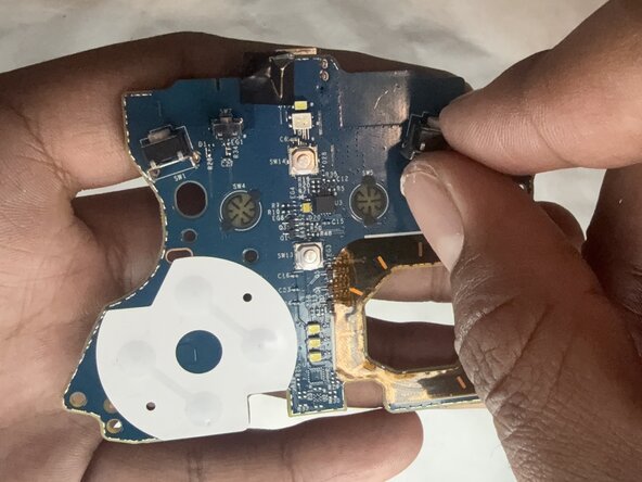

      • Inspect the bumper mechanism and internal switch components for signs of wear, dirt buildup, damage, or misalignment.
      • Carefully press the internal bumper switch by hand to test whether the button responds properly when activated.
      • Check for inconsistent clicking, sticking, delayed response, or a lack of tactile feedback while pressing the switch.
      • If the switch feels unresponsive or uneven, the bumper assembly or internal switch may require additional cleaning, repair, or replacement.
      • If dirt or debris is visible around the switch area, use a dust blower, and gently clean the affected area using a cotton swab lightly dampened with isopropyl alcohol or contact cleaner.
      • Avoid applying excessive amounts of liquid directly onto the circuit board, as moisture can damage internal electronic components.
      • Press the switch repeatedly during cleaning to help loosen debris and improve button responsiveness.
      • Allow the cleaned area to dry completely before reassembling or testing the controller further.

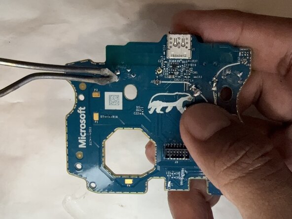

      • If the tactile switch is damaged or no longer responding properly, it may need to be removed and replaced.
      • Be careful, as the soldering iron becomes very hot and can cause burns. Work in a well-ventilated area while soldering to avoid inhaling fumes.
      • Heat a soldering iron and place the desoldering wick over the solder joints connected to the switch pins on the circuit board.
      • Carefully apply the soldering iron to the desoldering wick to absorb and remove the existing solder from each switch pin.
      • Continue removing solder until the tactile switch is no longer firmly attached to the circuit board.
      • Use tweezers or small pliers to gently lift the faulty switch away from the board once all solder connections have been released.
      • Avoid pulling on the switch with excessive force, as this can damage the solder pads or traces on the circuit board.
      • Allow the board to cool briefly before installing a replacement switch or continuing with additional repairs.
